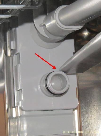

Hi all ! The middle Inno wash sprinkler (midea mid60s900) began to rotate poorly. I took it off, there were no deposits, I put new O-rings on the pipes, the rocker arm barely moved, and the lower sprinkler rotated like a rocket. The only thing I see is that play has appeared (it sways quite a bit horizontally), but there is no wear visible to the eye. What to do ? :sorry:

Under warranty, we replaced the entire basket with Innovosh and also put on new rubber bands. Contact the service for warranty, 2 years after all. Or choose tight rubber bands yourself (on the pipes from where the water enters the rocker). This Innovosh turned out to be unreliable; it would have been better to install a regular rocker arm.

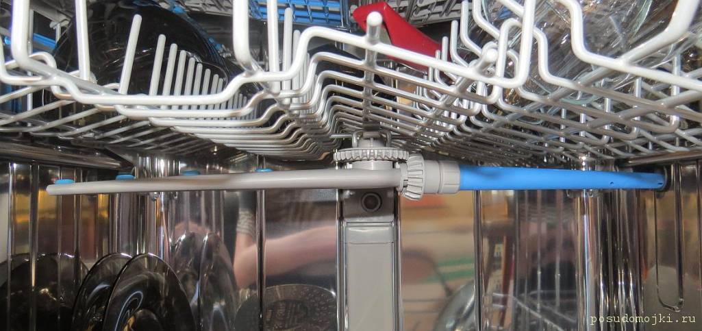

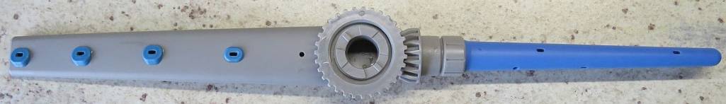

Machine MID60S400, after a little over a year the average innovation began to hang out like I won’t say what. If the basket is on the "top" floor, then this twister touches the pipe and stops, obviously, the quality of the wash suffers greatly.
They refused the guarantee, they offer to give them money (2,700 rubles) only for the twister. I couldn’t even find right away where you can buy this yourself, but in the same service a complete set of a U-shaped plastic water conduit for 3 sprinklers along with them (only there is not an innovative one, but an ordinary one) also costs 2,700 rubles, which is annoying.

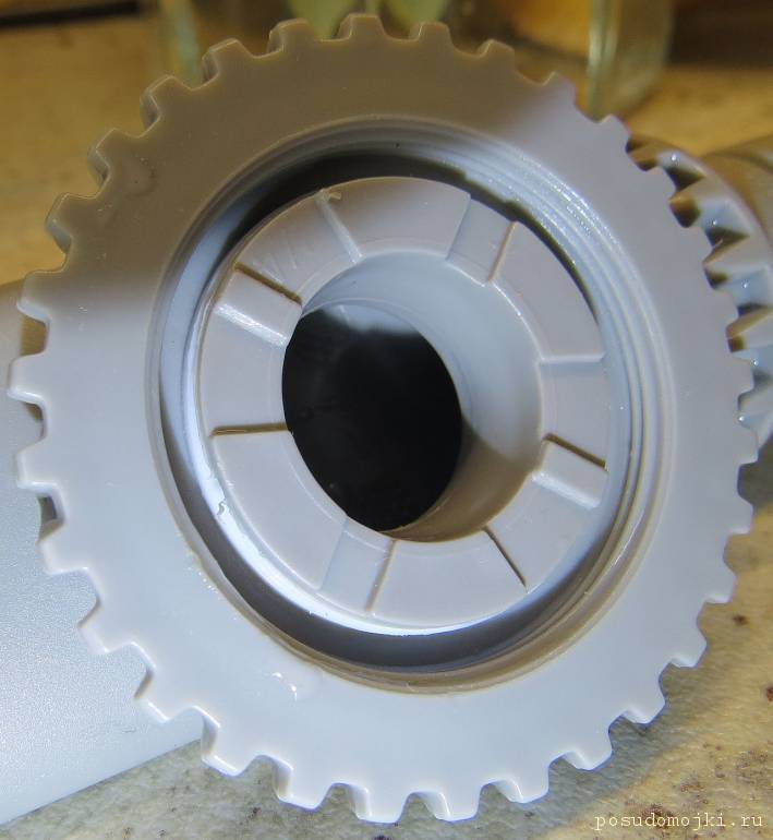

I don’t understand how to disassemble this thing in order to replace a gasket made of something white that has worn down almost to nothing. Can anyone tell me?
