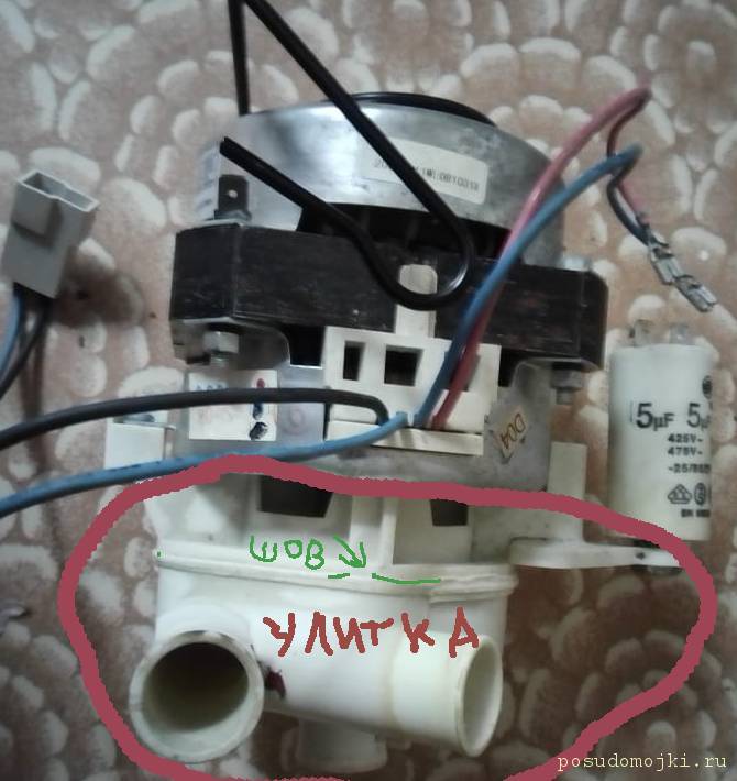

Post by Pavel »
After unscrewing the two screws from the body, the snail is not removed and does not open along the seam (both halves are stuck). Who took it apart, tell me?
How to open the snail in the Willing YXW65-2A pump - Улитка насоса 2023-09-20 21-03-51.jpg
Vrastrub
 Re: How to open the snail in the Willing YXW65-2A pump
Post by Vrastrub »
This volute cannot be disassembled - it is soldered at the factory
To remove it you need to unscrew the volute wheel - a 13mm socket wrench (nut on the wheel) and a slotted screwdriver from the back of the engine on the shaft unscrews clockwise (left-hand thread). Not sold separately. you can install a lower power pump Motor (circulation pump) Welling YXW50-2F (and eliminate the operation of the bypass valve)

Thanks for the advice, I’ll try to do it.
Compressor Oil
Post by Compressor Oil »
Removing the snail was successful, it took about 15-20 turns of the screwdriver. The cause of the pump leak was found, the nylon or graphite bushing was almost gone - it was worn out, only scraps were hanging. I worked for 12 years! I ordered a new bushing from Ozone, repairs are ongoing. Thank you again, you are probably an experienced specialist?
