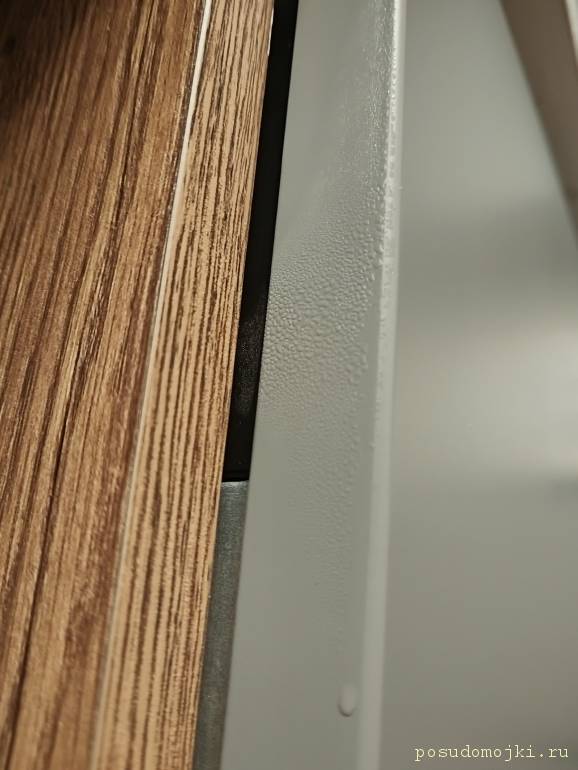

Hello. Help with a question. Along with the kitchen, a new Haier hdwe9-191ru was installed; during operation it has an incomprehensible problem, namely, steam condenses in the sides of the door and settles on nearby doors and niches. For my part, I even adjusted the seal, pulled it out a little, but it didn’t help. What could it be connected with? There is a feeling that steam is escaping at the locations of the side plugs under the screws that attach the PMM to the niche, but there the seal also fits tightly to the door

The same problem with the Haier PMM, but the model is different. I removed the front from the door, ran it a couple of times in different modes, no condensation appeared.

In my case, it was as if the façade prevented her from closing completely, but I only see such a connection. Because when I took it off, the perspiration no longer appeared. It’s a pity I did this late, because the wall next to the dishwasher was already swollen due to moisture. I don’t know about you, but in St. Petersburg Pioneer Service is responsible for the warranty, but there are such reviews about them that I didn’t dare to contact them.

Yes, without a façade for now. I haven’t figured out what to do next yet. But without a facade it works clearly. Until I took it off, there was also sweat, such that it dripped onto the floor, I thought it was leaking somewhere. By the way, I weighed the facade, it turned out to be 5.7 kg. It means it’s too much and it doesn’t fit the machine.

He promised to unsubscribe as soon as a new PMM arrives. I came, installed it, without the facade everything is fine, with the facade it floats, by the way, the facade weighs 6 kg, 1 kg more than needed. It’s all about the weight of the facade. The company where we bought the kitchen said that the weight of the facades is not less than or 5 kg, like hmmm not very much, I don’t believe it, I will try to redo the facade, because when producing the kitchen at the factory, I gave all the documentation for the equipment, the weight of the facade was not taken into account , their problems are like that.
