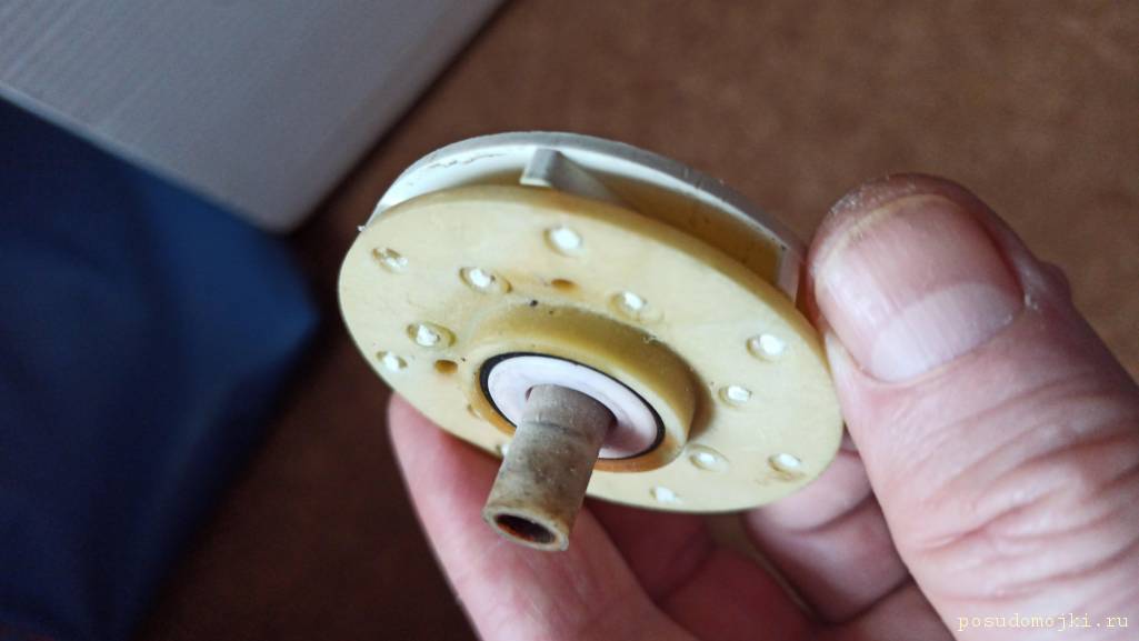

Post by atos610 »
Friends, should there be some kind of oil seal on the shaft or does the seal come only through a washer? Bosch machine, circulation pump impeller
deadog
Новичок
Total posts: 6
Joined: 08.04.2018
My dishwasher: Bosch SMV69T10EU/15
 Re: Impeller seal
Post by deadog »
There are 3 seals in total throughout the pump, 2 small and one large
Re: Bosch SMV69T10EU/15 Error E24 (Post deadog #2146)
If these 2 small ones are available, then there should be nothing else
