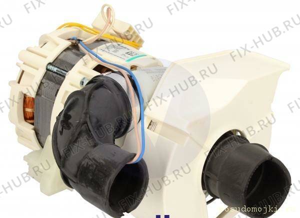

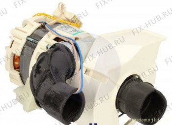

Good afternoon!
I ask for help from experienced resuscitators PMM. The problem is this: there is a Zanussi ZDT92200FA pump, a pump, as I understand it, a disposable Blackmann one. The impeller fell apart into two halves, at the moment I tied it together with a thin plastic tie (which is used to tie electrical wires together) through three holes at the base, now the machine pumps like new. But I assume that my happiness will not last very long:(
Actually two questions:
1. Maybe someone has experience on how to more reliably fasten the two halves together.
2. Is it possible to replace the existing pump with something else (even if it’s also a blackmann, but fresher. The original pump is already listed as a rarity and costs as much as a Boeing wing).
According to the catalog this pump is called : Electric pump for dishwasher Electrolux 140002106015
And it looks like in the attached pictures.
Pump impeller for Zanussi ZDT92200FA - Elektropompa_dlja_posudomoechnoj_mashiny_Electrolux_140002106015_UT-big-RU.jpg
Pump impeller for Zanussi ZDT92200FA - Elektropompa_dlja_posudomoechnoj_mashiny_Electrolux_140002106015-big-RU.jpg

starman: 11 Oct 2023, 12:10 Does anyone have experience on how to securely fasten the two halves together?
soldering...yes, yes, with a soldering iron.
nor use cyanoacrylate glue
