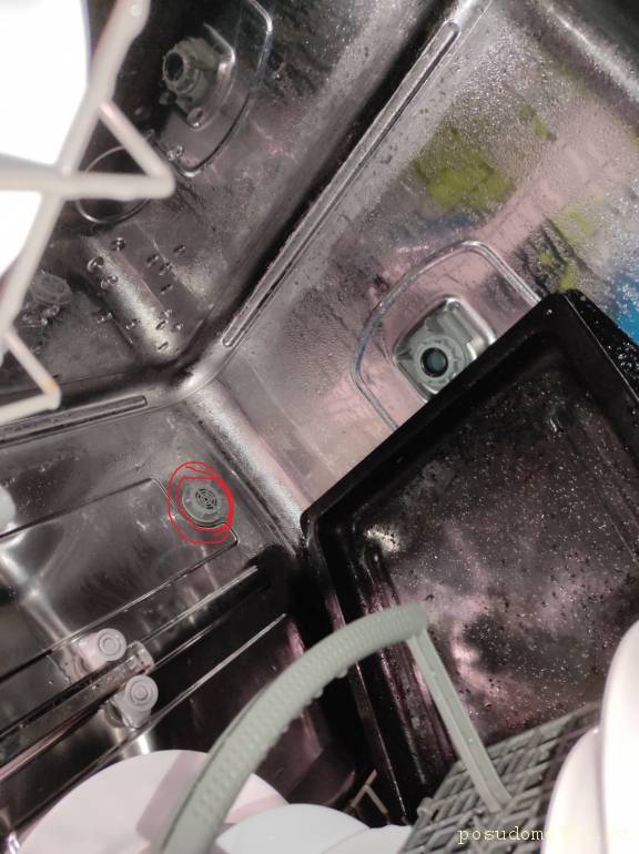

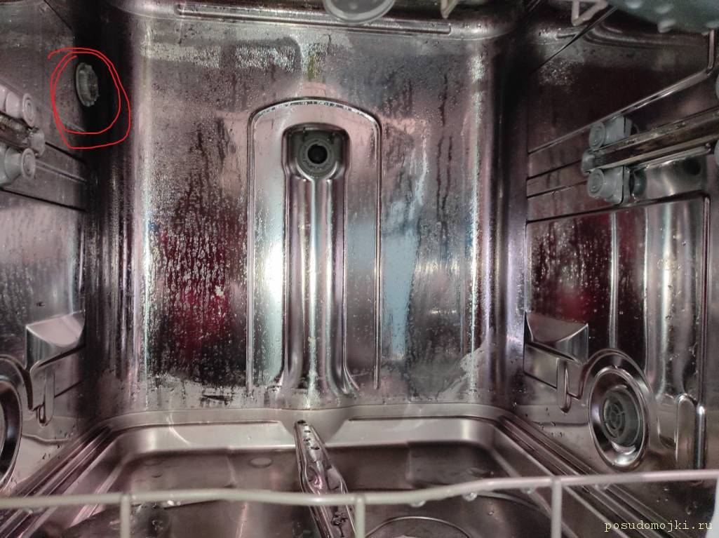

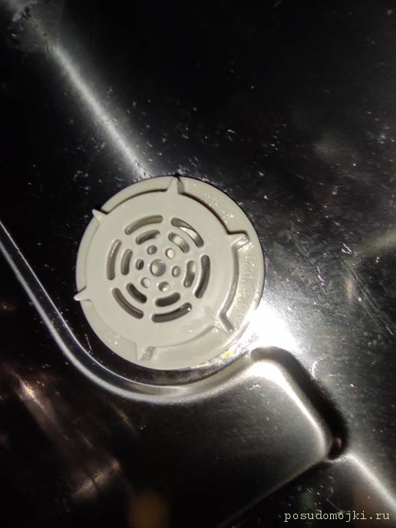

Hello
This is a problem - water flows into the dishwasher, through a round thing, I don’t know what it’s for, maybe for drying, I’m attaching a photo.
After the cycle is completed, if you don’t turn off the water supply with the tap manually, it will slowly , water leaks in a small stream and accumulates in the dishwasher itself.
Video here:
Pyramida DP-12 - water leaks into the dishwasher when the water supply tap is open. - 0-02-05-93aa4ad296c9362ded0ad40eb7e1c74b1775f53e214af77fc76f44bce779cd70_c7ab10360c6b69f4.jpg
Pyramida DP-12 - water leaks into the dishwasher when the water supply tap is open. - 0-02-05-a00522aebdb9a65dc16bc19b2b0fd1bad0f26abbdb899b6a252c3248fc1953b8_96be5d3ff6ba3330.jpg
Pyramida DP-12 - water leaks into the dishwasher when the water supply tap is open. - 0-02-05-c4b0d5d59262a0cefa700622e6e0ea5c12fa1604629f88e03f7a9b203ee8ae23_1c6cc43acfa9c403.jpg
Artem
 Re: Pyramida DP-12 - water leaks/leaks into the dishwasher when the water supply tap is open.
Post by Artem »
The condensate line valve from the heat exchanger may be faulty
