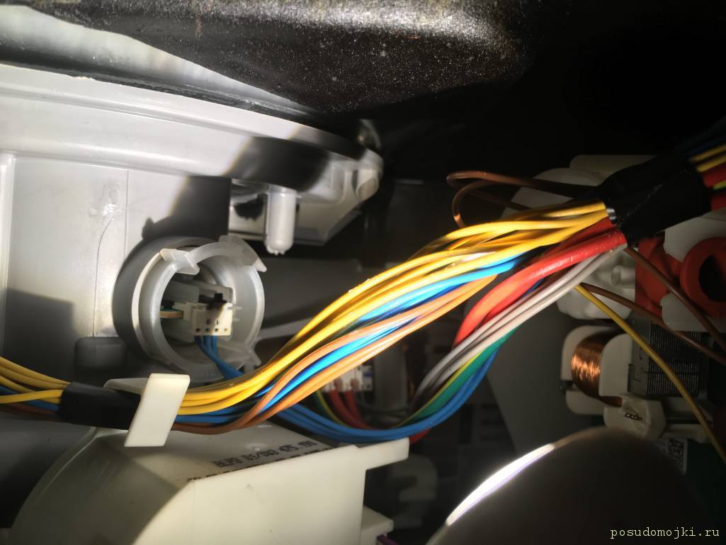

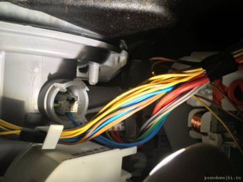

Neff dishwasher error E15 and the faucet is blinking, I removed the bottom panel, water is dripping from here. What could this be, how can I fix it?

Remove the plug from the socket, drain the water from the pan, tilt the PMM and place a basin in the place where the water flows out, dry the PMM for at least a day in a warm room, remove the blockage in the water drainage system, check the coarse and fine filter system for the presence of food residues, after all You can use these manipulations.

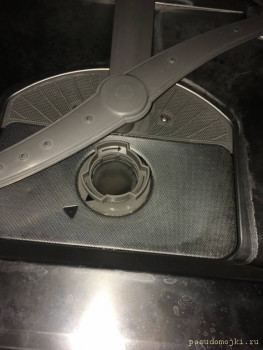

Thank you very much for the answer! Can you clarify where the coarse and fine filter system is located? Inside the hmmm itself, as in the photo? And it turns out that it is leaking from that hole due to a blockage?

Yes, in your photo you have exactly what needs to be checked, the filter that unscrews and is removed is for coarse cleaning, and the square mesh is for fine cleaning, be sure to check the drain hose and the siphon under the sink for clogging, if of course you have one, More often, a problem like yours occurs due to a blockage in the filters, drain hose, siphon, less often due to a blockage in the pipes, wear of the rubber gasket, or from an incorrectly installed PMM drain hose.
