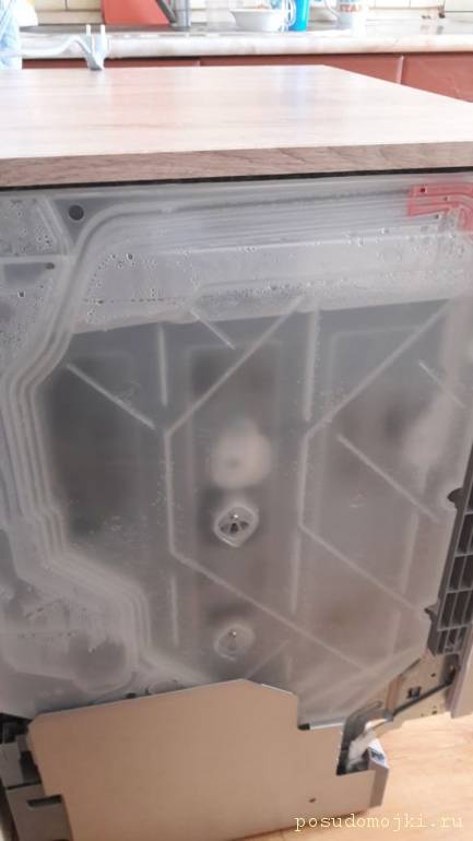

Good afternoon!
Please tell me, this is a problem after the end of the wash, there is water (stagnant) in the side wall.
After turning it on and starting it drains and a new one is collected and washes well, at the end of the cycle it is collected again water is in the side wall on the left (transparent plastic wall on the left) and remains until a new start.
Artem
 Re: Water stagnation after Bosch wash cycle
Post by Artem »
This is not a problem, but the correct operation of the PMM.

Good afternoon!
Is it possible to drain this water without opening the wall? I don’t plan to use the car for a long time. Dishwasher bosch spv2hmx5fr.
Deflegmator
Post by Deflegmator »
Solved the problem *x)
Runned the prev. rinse and stopped the program when the water was drained :good:
