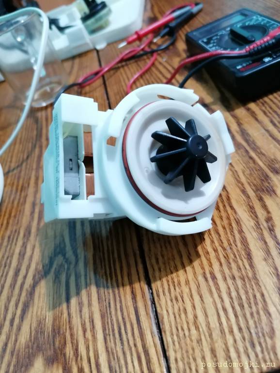

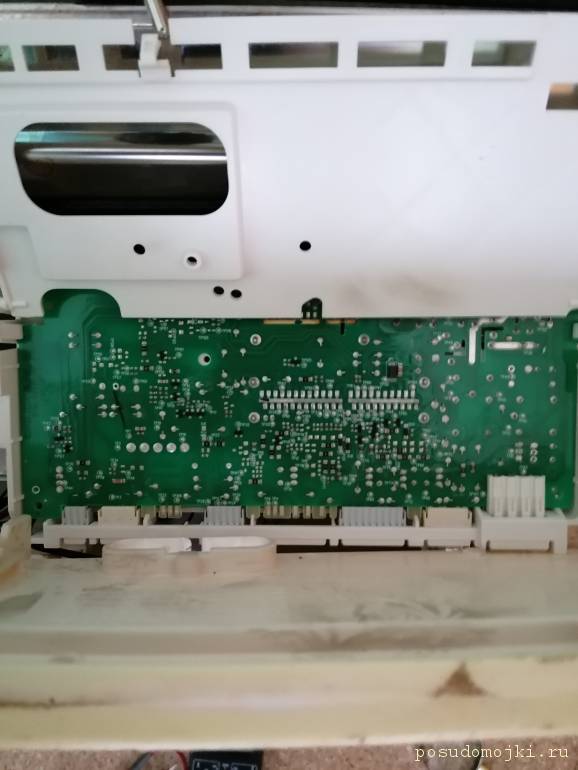

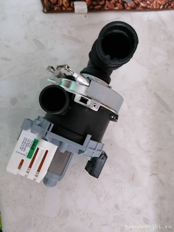

Good afternoon, please help me figure it out. When you turn on the machine, after a short period of time the wash and end of cycle indicators light up. Having surfed through various forums
they looked at similar topics, they write that these are problems with the breakdown of the circulation unit, somewhere there are problems with the washing chamber, etc. .d. The circulation block was disassembled, washed, checked
graphite bushings, internal diameter 5.2 mm, axis 5.0 mm. Output 0.2 mm. When 220 volts are supplied directly to the block, everything inside rotates perfectly. I also checked the pump when draining water everything works separately. All the parts inside the machine are clean, the filters are all cleaned. The hoses are all clean, water flows into the machine. There is salt in the machine. When you turn on the machine, water begins to flow, this can be seen visually, after a short period of time the water flow stops and this error turns on again, what could be the problem I don’t know anymore. There is no damage on the board.

Try cleaning the pressure switch chamber,
