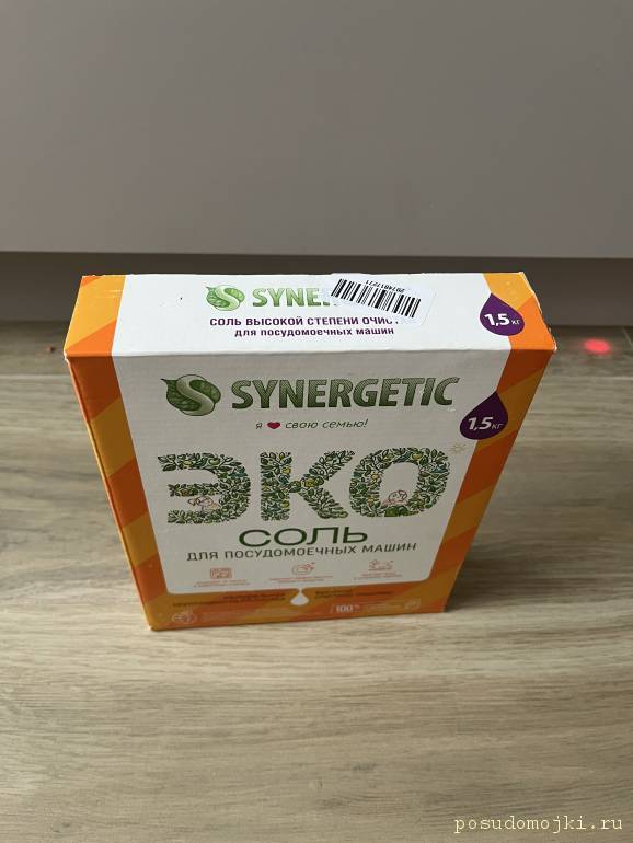

I have the same problem, it has never gone out, we have been using it for 2 weeks since new. PP bosch smv 25AX00 E Polish assembly.
It seems to be using up salt, I set the hardness to maximum in the settings.
Is it normal that the sensor does not go out? salt synergetic
The salt indicator does not go out in the new Bosch SMV25AX01R - BB858DAD-6B71-4921-AB84-8D86C79FE1C7.jpeg
