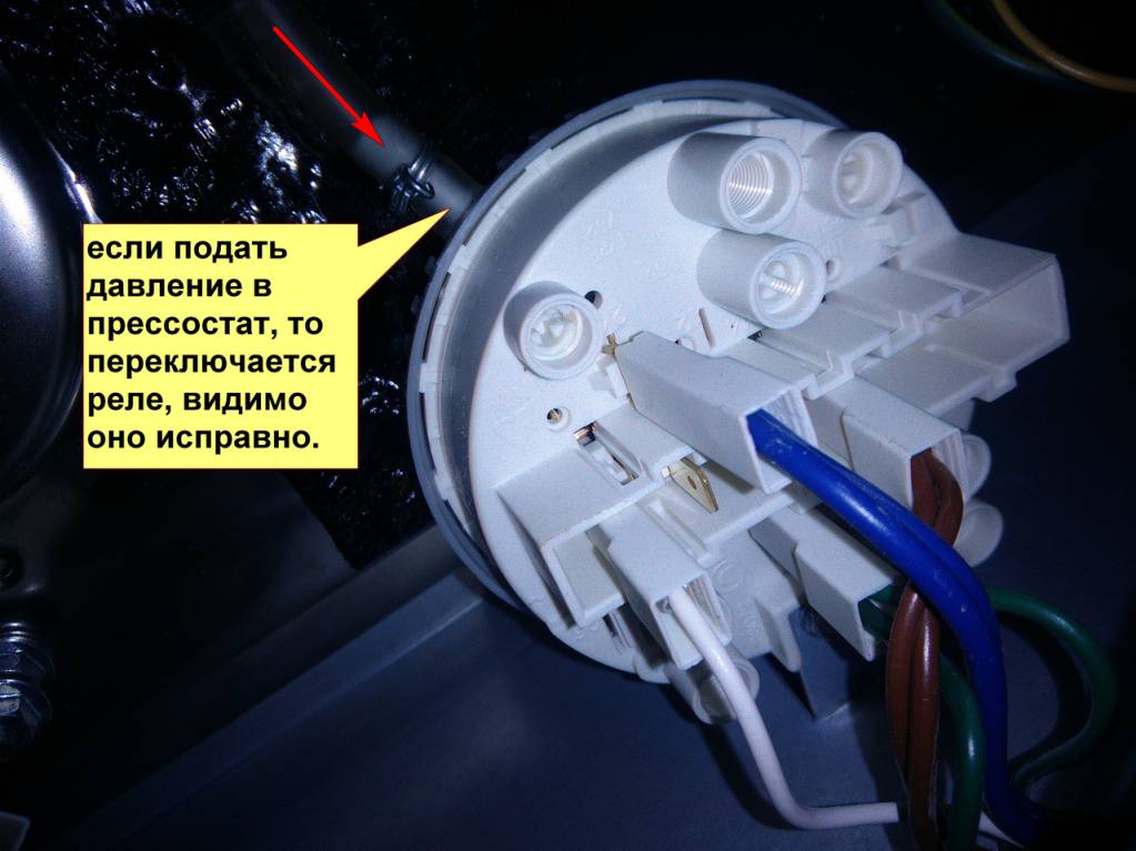

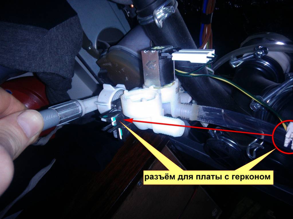

Hello dear forum users! I have owned the PMM for about two years - candy trio 9501x, there have been no problems with the operation of the PMM. Over the past 2 months, a couple of times during the execution of the dishwashing program it gave an error. There is no display on the PMM; according to the symptoms, it seems that it cannot draw water. After turning off the program and restarting it, the PMM worked through the cycle completely and completed the work without errors, and then the day came when the PMM didn’t want to work. I removed the water intake valve, checked the coil - it is working (without connecting the reed switch and the dishwasher when voltage is applied), the reed switch is working (closed when inserted into the valve body and adjacent to the metal plate, the reed switch itself is on the board in a plastic case, which is not dismountable. If move the reed switch away from the metal plate, it opens). When any program is turned on, no voltage is supplied to the water intake valve, and when turned off it jumps to 30 Volts or higher. Does anyone have any thoughts? Maybe the programmer is dead? Just don’t bother with Google and the service, thank you!

If there was an RCD, the cause would have been revealed sooner. The diagnosis of the breakdown is a faulty heating element, after replacing which the PMM operates normally. Thanks for your help!!!
