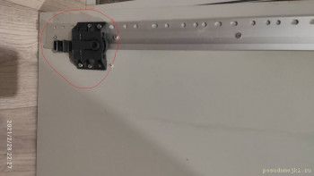

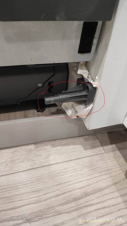

Artem, I can say that after removing the facade from the PMM door, the washing cycle went from start to finish without the program freezing as and is due to the corrected unit. The range of diagnostics has narrowed, I will look for faults in the mechanism for installing and fastening the facade to the PMM door. When removing the facade, a slight play was noticed in the hinges and fastening slides, which required adjustment. I will definitely check the door lock as you indicated. Thank you very much for participating in my problem.
