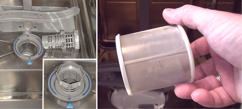

is there is a high probability that the cause of these malfunctions is that the water supplied to the direct-flow heater of the machine cannot get there due to a dirty fine-mesh cylindrical filter, which stops passing or does not allow enough water to pass into the heating element. The heating element essentially heats the air and, when the heating element body heats up to a given temperature, the thermal switch turns off the heating and the board gives the command to wash. But what?
From here, when you start washing with supposedly hot water due to its absence or insufficient quantity, the machine adds water, but cold. Hence the poor quality of washing and error E??? (the error number depends on the model and brand of the dishwasher and means that there is no water heating)
Due to dirty filters, the lines become clogged with grease deposits. It is also advisable, when using low-temperature programs, at least after 3-4 washes at low temperatures, to use a high-temperature program to additionally clean the machine and filters from grease deposits inside the machine itself.
Repair method:
1- Shut off the main water.
2- Open the machine, pull it out and wash both filters (especially and necessarily the cylindrical fine-mesh filter) with a stiff brush. (so that all cells are clean through the light) p3- Rinse the machine with hot water without replacing the filters
How to do it:
A) Boil 2-3 liters of water in a saucepan or kettle.
B) Open the machine door, if it was closed, and pour boiling water onto the bottom (there should be no dishes in the machine ).
B) Press the “NETWORK” button and turn on the last program.
D) Close the door
The machine will carry out the draining program, and since the main water is turned off and will not enter the machine, after draining , press the “NETWORK” button, that is, turn off the machine, open the door and !
Repeat the operation according to points: A, B, C, D at least 3- 4 times
After completing all washing operations, install the cleaned filters in place, open the main water and carry out a test wash.
The problem will be fixed

The dishwasher does not clean well, does not heat the water, and does not complete the cycle. Error E . Repair methods - Чистка-сетчатого-фильтра.jpg
