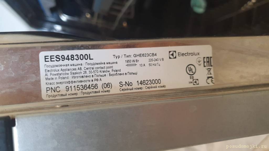

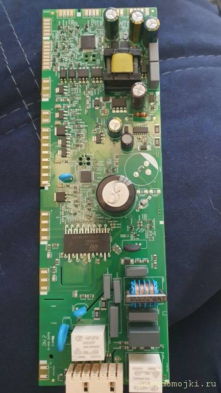

Dear professionals! There is a machine PMM Electrolux EES948300L, which simply does not turn on (sensor panel). The last time it blinked it turned off, then it blinked again and that’s it! I invited 2 technicians, the first one tested everything and said that it was all about the control board, it needed to be further examined. The second master arrived, also paid attention to the board, and together we went to further examine the board. Verdict: The board needs to be reflashed! Next, I reflashed the board in Zip-m, on the street. Kirovogradskaya 15, shopping center "Electronic Paradise", there is a firmware version. I rebooted on the second try. But I connected the board (while it was lying down) and it still didn’t turn on. What can you recommend? The machine worked for about a year, it’s new, but 1.6 months have passed since the purchase. (one year warranty).

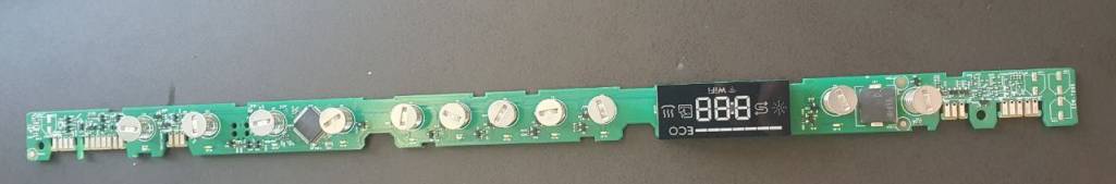

Sent after 2 minutes 11 seconds: Does anyone know indication board (touch panel) - is it reflashing?
Плата индикации EDW7200, код 140182227094

It looks like the reason is in the display board (touch buttons), the firmware has crashed... In Russia, as it turned out, no one is flashing... I’ll have to buy it - and it costs 12 thousand... It’s a shame. It’s a shame that the company itself doesn’t even bother to service its own equipment, and yet so many of them are offered for sale!!!
