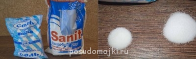

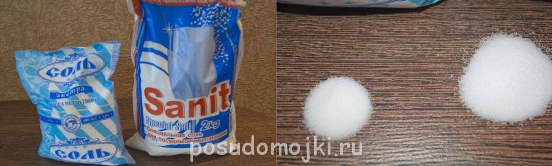

For about a year I used Extra instead of special salt. The quality of dishwashing was excellent. But recently I noticed that a kilogram of salt began to be enough for fewer washes. The salt shortage light began to light up more often. I don’t know what this is connected with. I taste the water from the tank after the light comes on - it’s fresh. Those. the salt disappears somewhere.
I bought 2 kg of special salt of the Sanit brand in Auchan for forty-odd rubles, I want to see after what period the light bulb lights up.
By the way, this Sanit salt is not crystalline, it looks like regular finely ground salt.
Ingredients: sodium chloride, surfactant. And it is written that it should not be eaten.
I liked that the price of this salt is close to regular food salt, only twice as expensive.

About the salt. I bought this salt in Auchan, the price for a 2-kilogram bag is 50 rubles, but it chokes the toad, because... I didn’t find any differences.

Hi all. Pmm purchased two years ago. the first time they filled up with special. salt, then add only extra salt. the quality of washing has not decreased. The water is very hard, the settings are set to maximum.
sergeyssv82
Regular salt
below in the right corner is the composition.. And this is the finish.. Ugh! I was cheated for once, it’s really a shame.. I’ll add extra with water right away so that it doesn’t coke
