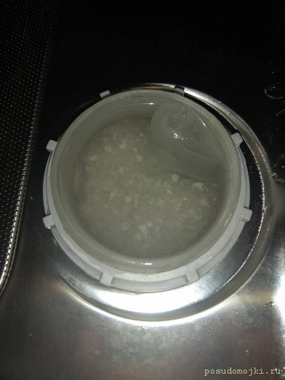

good afternoon.
Candy Brava CDIN 1D672PB-07
in use for several months, the inscription SALT appeared, I added salt but the inscription did not disappear, several washes have already passed, the salt in the tank seems to be decreasing.
today, following advice from the Internet, I scooped water out of the salt tank twice, then added water, then added salt again, added water, mixed the salt with a stick, started the washer, but nothing changed :(
nthe instructions say when the message appears, just add salt and that’s it.
Is there anything else that can be done?
Candy Brava - the inscription SALT is blinking but there is salt - IMG_20220827_141528cr.jpg

I cleaned the washing chamber, many dishwashing cycles have already passed, the salt is decreasing, the message is still there.
I bought salt from another manufacturer, as soon as the salt that has already been added significantly decreases, I will try to fill it with new one.

In general, I’ll waste salt and then we’ll see

in general the problem was somehow solved. the salt was almost all gone and the inscription disappeared, I filled it with the same salt almost until it was full - the inscription no longer appeared, everything worked fine.
