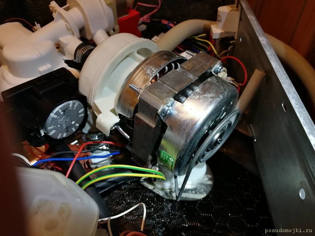

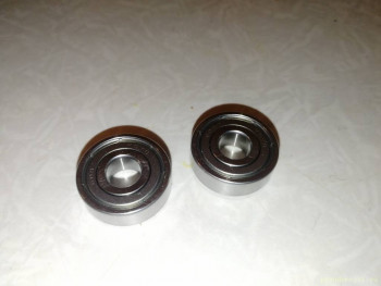

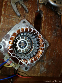

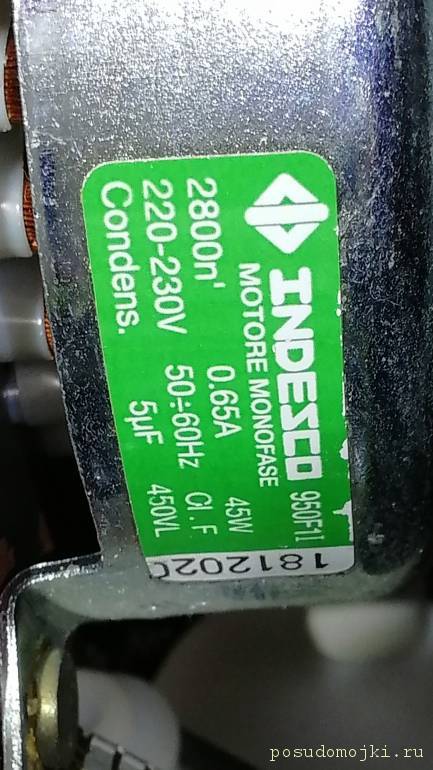

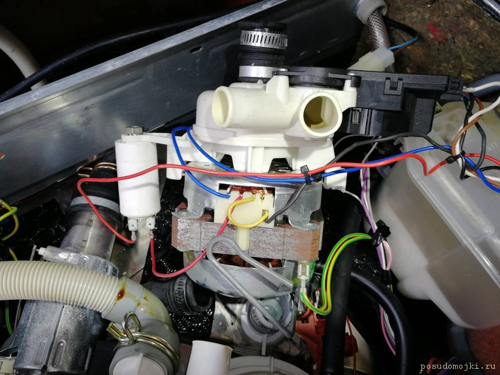

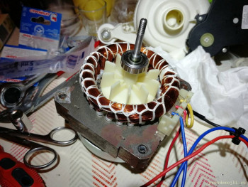

Post by Fulcrum »

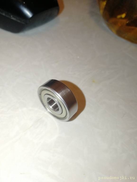

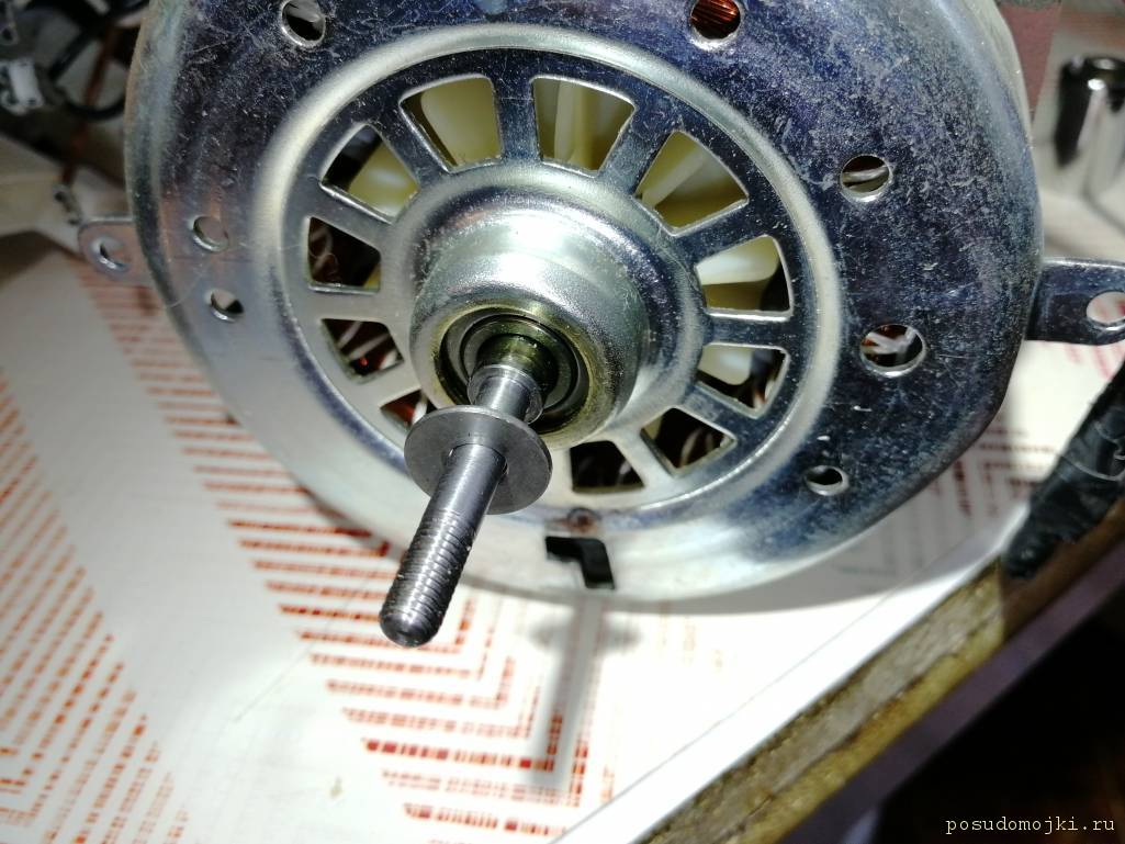

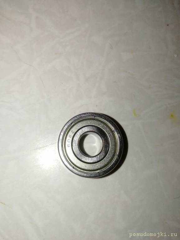

The bearings worked for 20 years, there was a noise, the motor was on rivets, I drilled it out, installed the bolts, they are SKF, I will change it to Koyo.

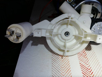

Good afternoon Fulcrum! How to remove the impeller in this pump, what is the direction of the thread. I try to unscrew it, but the effort feels excessive for this type of plastic.
Total posts: 61
Joined: 05.02.2019
 Re: Bearings for indesco engine (Ariston)
Post by Fulcrum »
The pump has a reverse thread, turn it clockwise
