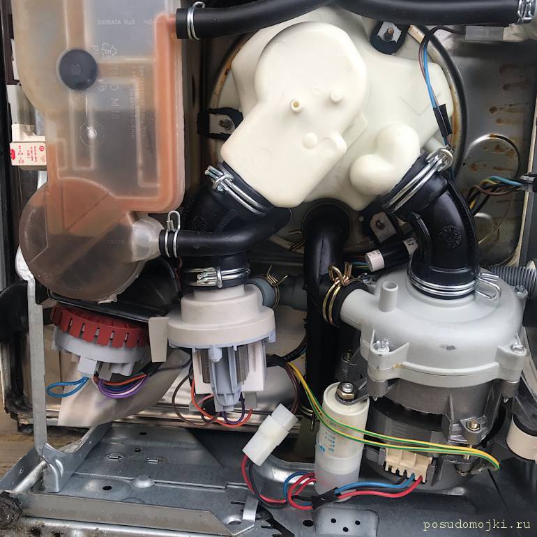

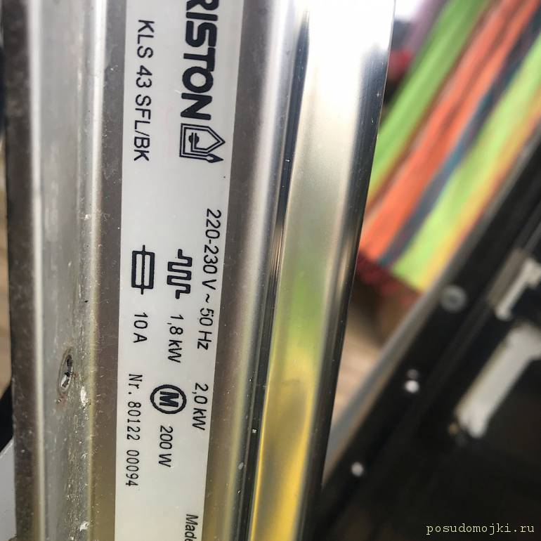

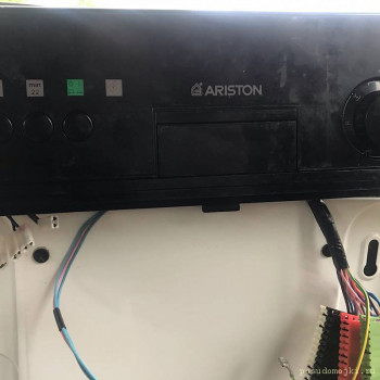

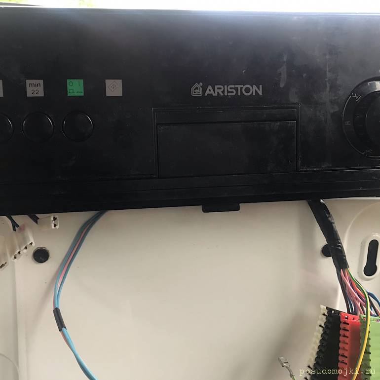

Hi all. Please help. This device is available. The problem is this: there is power, the indicators are on, but nothing happens. Choose mode and silence. Recently, sometimes there was a problem, you start a cycle and it could sometimes freeze, erase without stopping. Or another cycle would skip and erase the next one.
I think maybe the problem is in the manual control, something broke there. I took it apart and it was all solid and with rivets. I’m not sure that one can even be found now.
I took apart the bottom and visually there was nothing burnt. What to check, how to find the problem.

Yes. Thank you. The wires were broken in the braid at the bottom bend.
