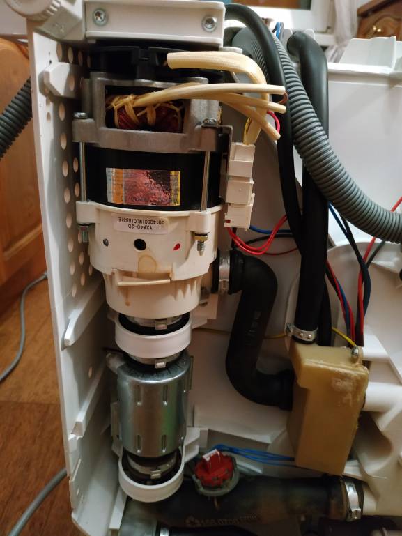

Greetings to all. A couple of months ago, the Welling YXW40-2D circulation motor on an Electrolux 2300 OK dishwasher jammed. A small amount of water got onto the bearing due to wear out of the rubber bands or something. In our city (Murmansk) there are no normal craftsmen, only one name. All service centers and others immediately sell a new engine, which costs about 6,000-7,000 thousand rubles. I decided to do everything myself, and found a bearing for 200 rubles according to the markings. Japanese, re-pressed it at a service center for repairing car air conditioners for another couple of hundred rubles, I had to modify one broken gasket at the bearing. As a result, the entire repair cost a maximum of 500 rubles. The dishwasher works almost around the clock due to the large volume of responsibilities assigned to her))). Yesterday I noticed a short-term, infrequent creaking noise when the pump was running and it seemed like it was again a bearing, which again most likely got water in it. Hence the question, does anyone have a repair kit for this engine? I’m interested in the cap with a rubber rim, which is located under the engine impeller; perhaps that’s it. Well, or maybe someone can suggest a service center with a zip for such engines... I really don’t want to buy a new one for that kind of money.
