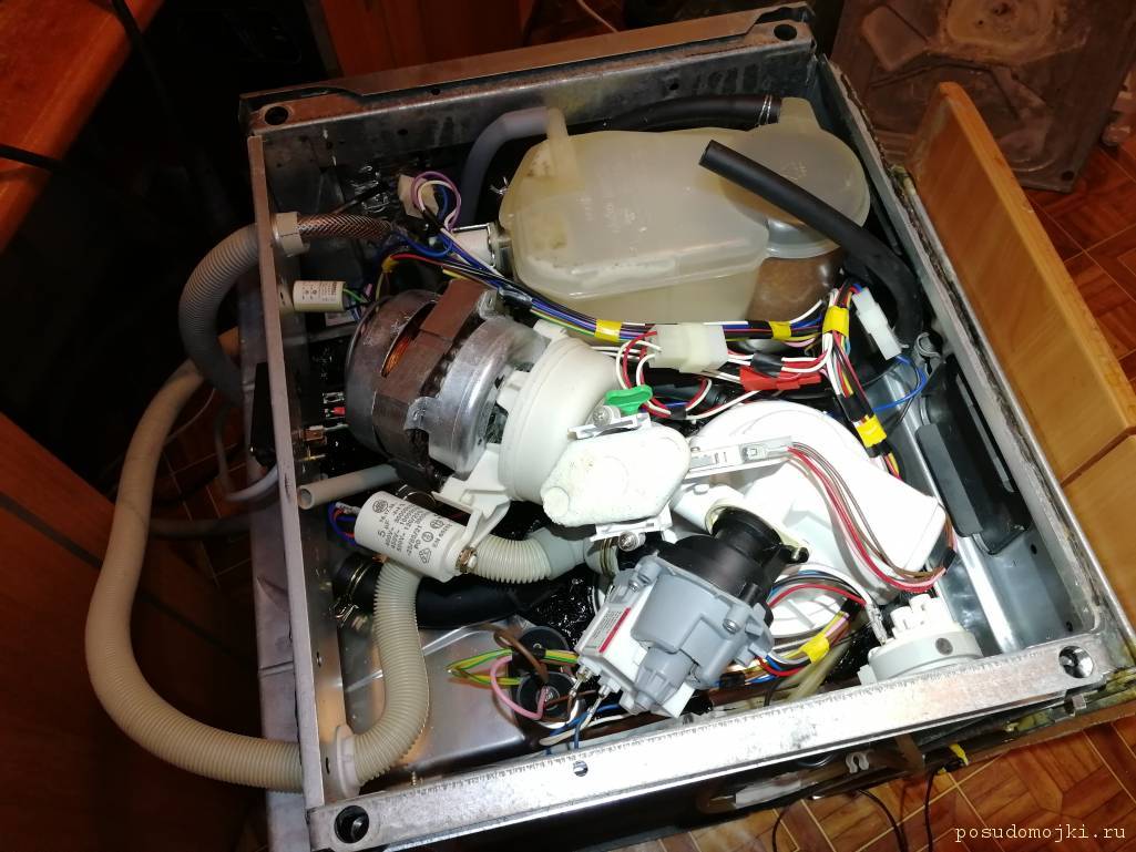

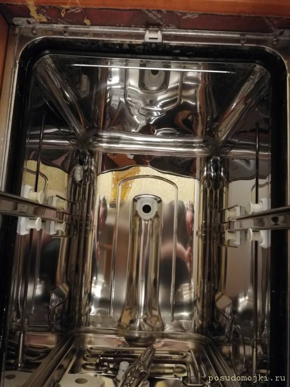

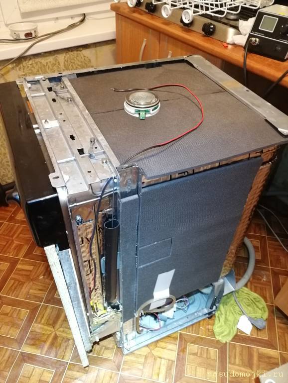

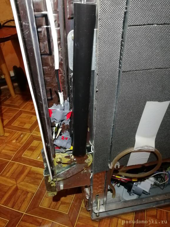

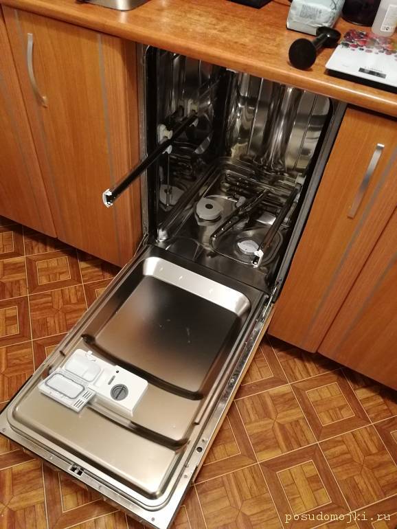

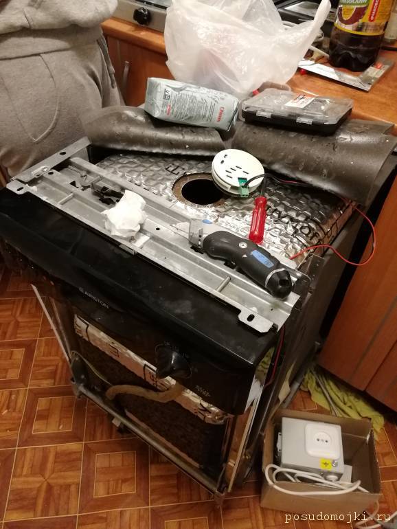

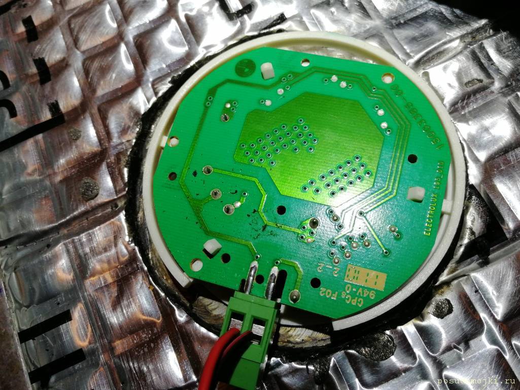

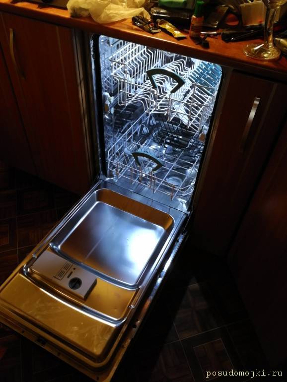

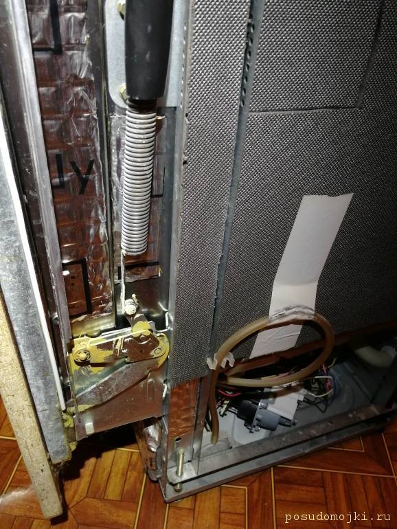

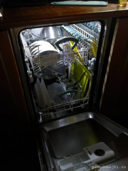

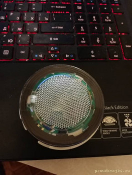

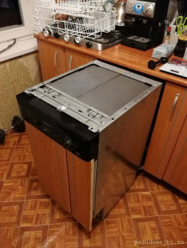

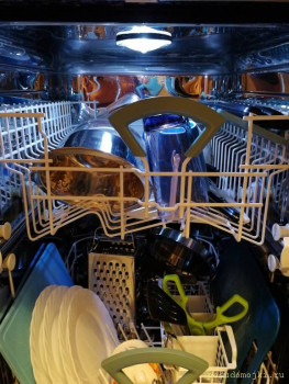

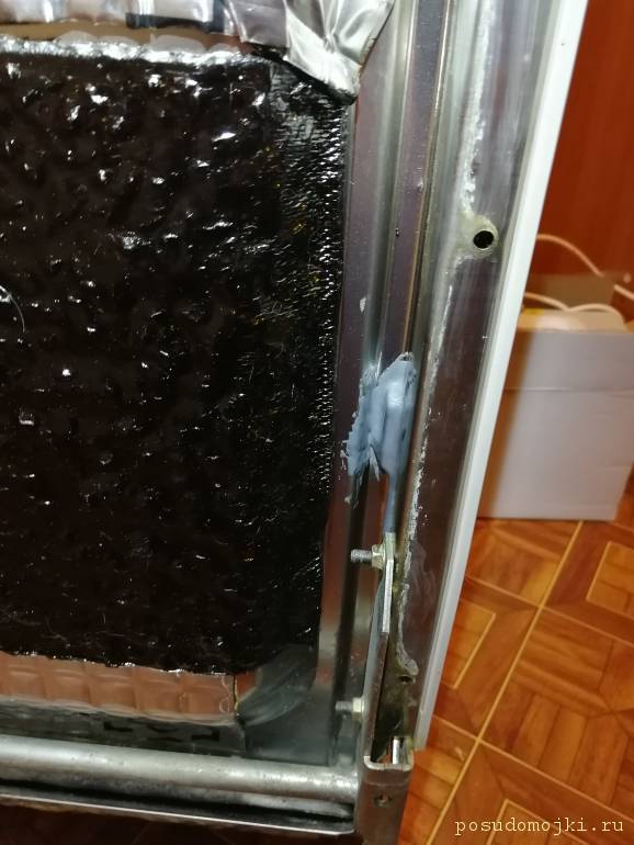

Our Ariston dishwasher is 20 years old, we are not going to change it, because they don’t do that anymore, it washes better than modern ones and has a longer life... I have already done noise insulation for it, now I decided to add lighting, it turned out very cool, here you go I decided to share a photo... I bought the backlight itself at a disassembly from an Electrolux machine for 500 rubles, a switching reed switch (Ryazan) 200 rubles for 220 volts 1A, a neodymium magnet 190 rubles, I had the wires...
