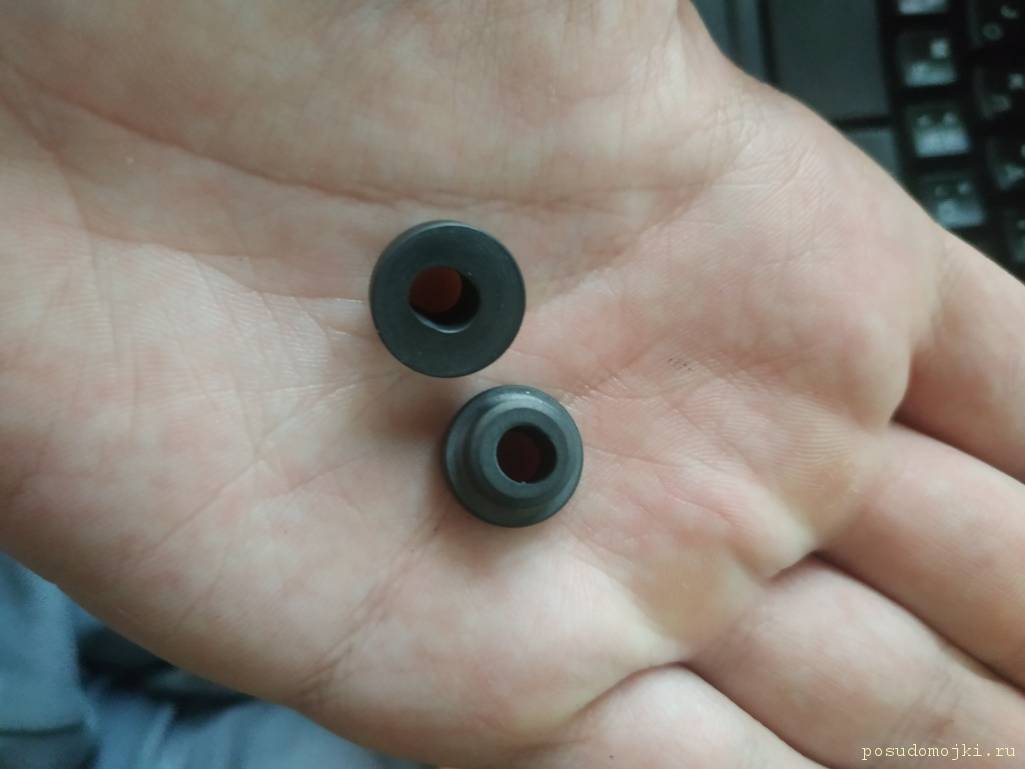

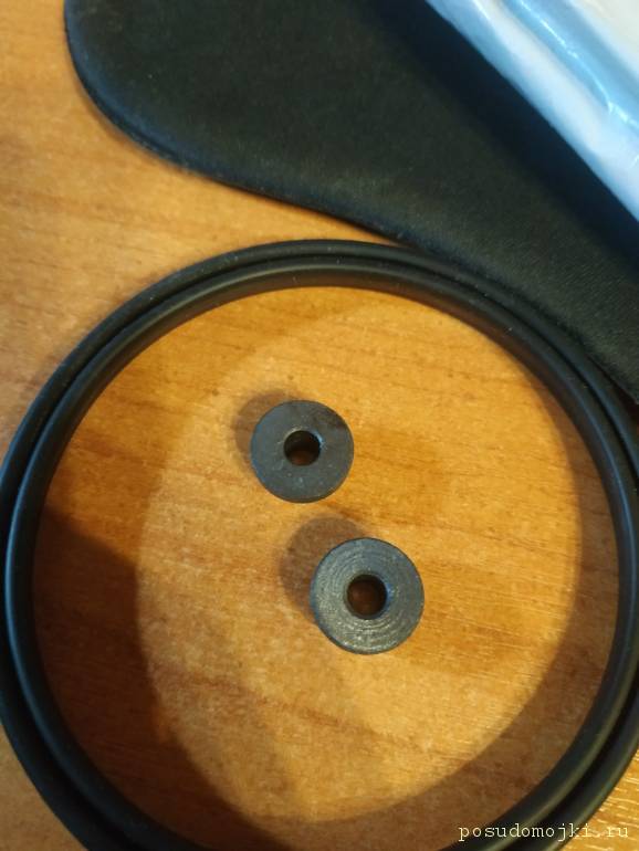

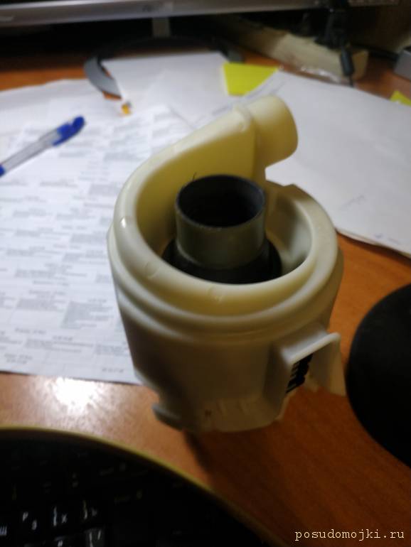

I replaced the bushings of the circulation pump - everything was fine again, the wear on them was, of course, bad

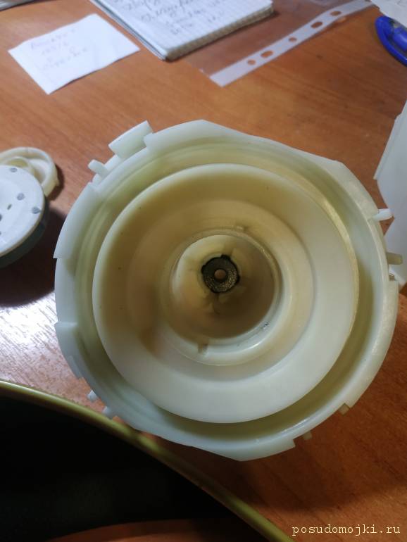

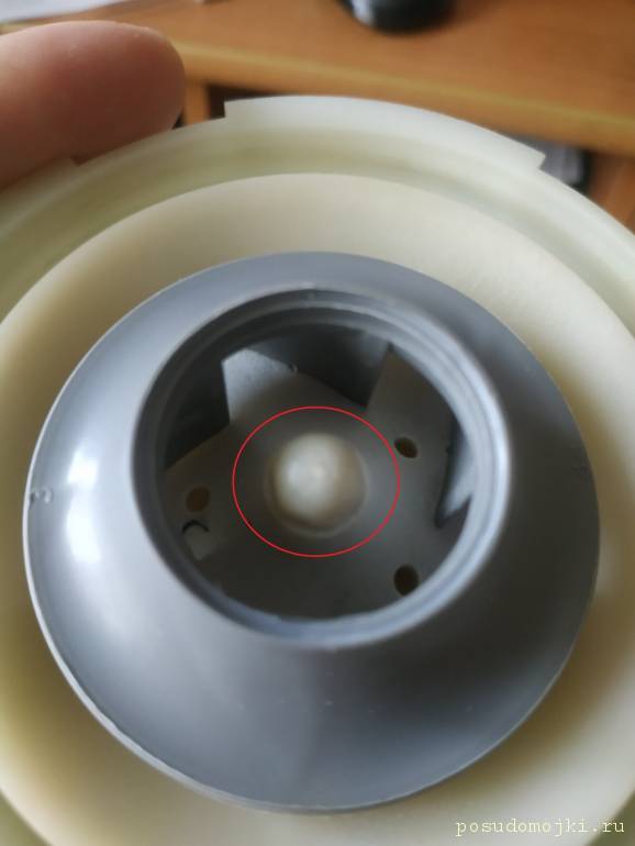

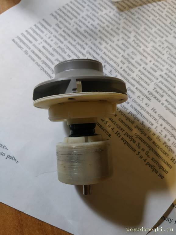

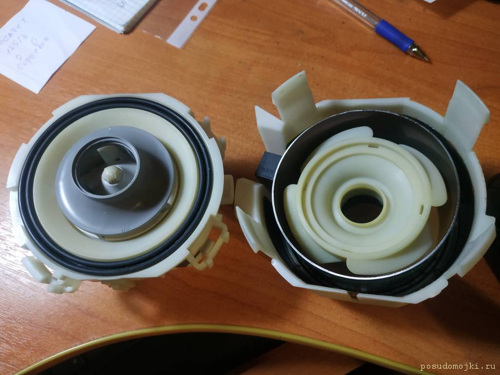

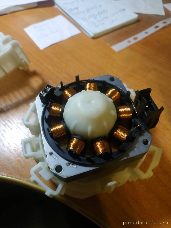

1) We remove the pump itself 2) We pull the snail off it, safely breaking off the 4 latches (since they are very fragile) , it turns out like this: 3) Remove the plastic winding protection by unscrewing 2 screws (in principle, you don’t have to remove it, but it’s easier to remove the armature this way) 4) Using pliers with large or medium jaws, we cling to the central part of the impeller and rest With your feet on the floor, remove the pump housing from the housing (you will have to pull strongly), not jerkily, but evenly and forcefully. You get this picture (in the photo there are 2 seals on the shaft, I put them on just so as not to lose them, in this place there will be the first bushing with a seal An impeller with a left-hand thread, self-tightening during operation from the flow of water! That is, you need to unscrew it according to clockwise!
The second bushing with a seal is located at the bottom of the body Making bushings Actually we change these 2 bushings and assemble everything in reverse order
