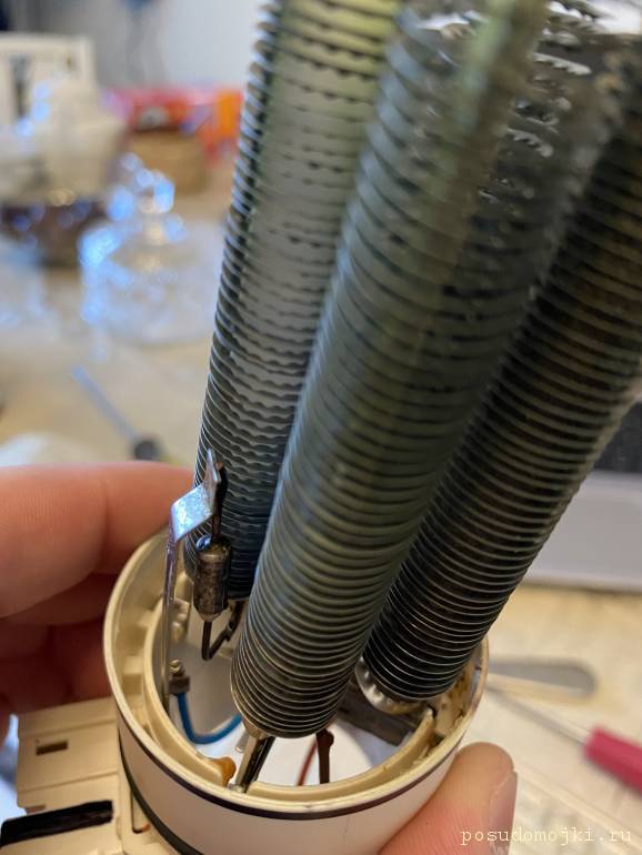

Good day to all. Need some advice. The Bosh SMV69T90RU/93 dishwasher generated error U10. If I’m not mistaken, this is a malfunction of the zeolite dryer. I took it apart, the heating element is in a glass cup, no ringing. There is a thermal fuse, the heating element is working, the thermal fuse has blown. Question: Does anyone have information on the temperature and current of this thermal fuse? Give almost 12,000 rubles. for a new one, considering that it’s only the fuse, it seems to me overkill.
