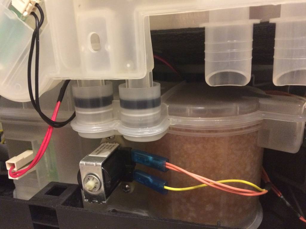

Post by Evgeniy22104012 »
In general, I recently encountered a problem, I turn on the PMM mode, water is drawn in... It draws water and stops with error E2. I read various tips that it could be a pressure switch, or a blockage. or just a software error. They advised to disconnect from the network and wait. I unplugged it and immediately went to take it apart to look at the blockage. I opened the side wall and there was some kind of yellow liquid there. This is what interests me, which is why I went to the forum (I attach a picture). What is this?
in fact, the PMM started working after resetting the program. no repairs were required, I just don’t want to collect it yet until I find out what kind of yellow liquid it is, in case it shouldn’t be there
 Re: Error E2 for PMM Leran BDW 45-096
This yellow liquid is an ion filter. The capsule is filled with small balls 0.5-1 mm (I don’t remember their composition) when interacting with NaCl, these balls reduce the hardness of water.
