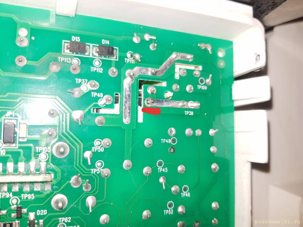

Good day everyone!
The machine began to show error 13. I found on the Internet that this heating element is faulty. However, having removed it and called it, I came to the conclusion that it was a worker. Resistance is 28 ohms, both fuses are working. I removed the control board, everything looked OK, nothing burned. I read descriptions that the contacts on the heating element relay were loose, after soldering everything worked, but I don’t know anything about the board itself, where is this relay? What else could be the cause of error 13, besides the heating element and the board?

Post by Zoer »
I asked myself, and I answer myself)))
Once again I removed the control board, examined it from all sides with passion, and saw one contact of one relay poorly sealed. It seems that due to heating, the remaining tin completely melted and flowed out, the contact was lost. Oh, this lead-free soldering)))) In general, I soldered the contact properly, everything worked. By the way, I also carefully looked at the power wiring of the heating element, it comes directly from the board, there is nothing else there.
In general, I am disappointed with this approach of the European manufacturer. The car is 6 years old. And in general, the insides are not pleasing with the quality of workmanship.

Post by Naleev »
Thank you
I also soldered the leg on the relay without directly disconnecting the board from the cables.
Access to the board is simple: unscrew two screws, open the lid, slide the board body, slightly open the lid - that’s it
