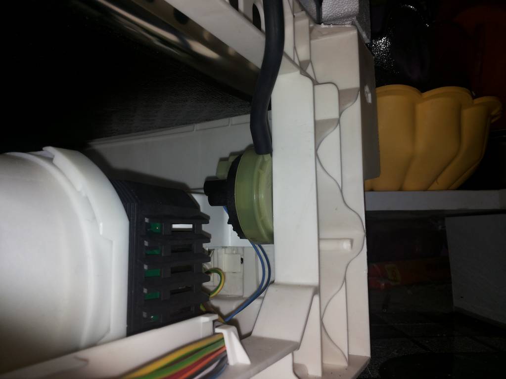

PMM HOTPOINT-ARISTON LST 5397 constantly got error 5 (the LED blinks and 5 lights up on the screen) some time after startup. It was collecting water and error 5 popped up, after which the drain pump hummed. After searching for information on the Internet, I realized that there is no specific data on errors for my machine.
Everything indicates a problem with the water level sensor (PRESSURE SWITCH):
- I removed the sensor and blew into it - it clicks
- the contacts rang - they are closed
- I blew out the hose with the valve that goes to the sensor from the tank
- I cleaned the contacts in the connector
After these manipulations the machine started working ! I also wanted to clean the salt tank, but I didn’t have time.

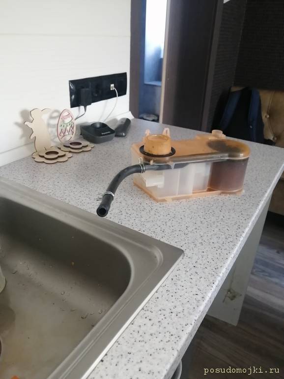

How to clean the salt tank in an Ariston
Kvs
 Re: Error A05
Post by Kvs »
It’s sealed along the way...
Kvs
 Re: Error A05
Post by Kvs »
In short, I poured anti-clogging agents in there. Washed it. So far there is no error and the rinsing mode is normal

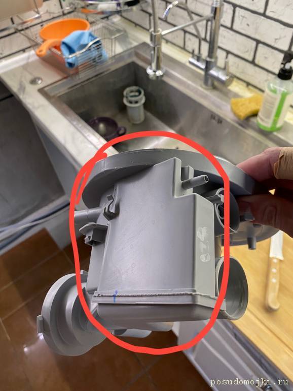

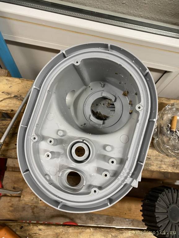

Guest: 25 Jun 2020, 18:43 The whole problem is that the so-called air pocket gets clogged (an air bell can also be called).
Thank you, kind stranger. Never in my life would I have guessed that this pocket could become so clogged. Everything looked clean, but as soon as you blew the compressor “in the return”, so much crap was thrown out of there... And yes, washing this thing is completely useless. You can’t wash it with anything.
Aksenov
 Re: Error A05
Post by Aksenov »
I’m bringing a photo. It is impossible to clean it without disassembling the structure.
вот этот карман. он заварен, неразборный.
воо что было внутри. и это еще не все…
