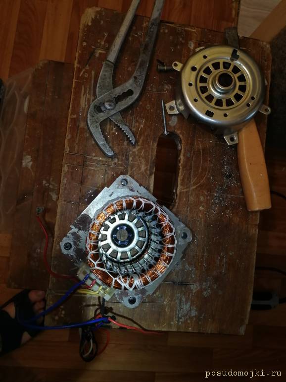

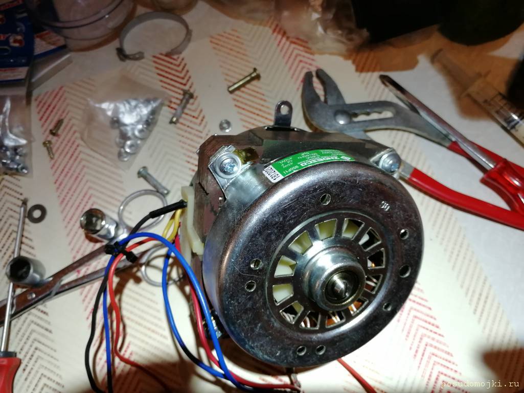

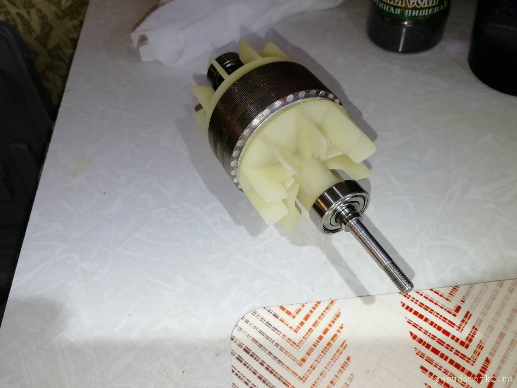

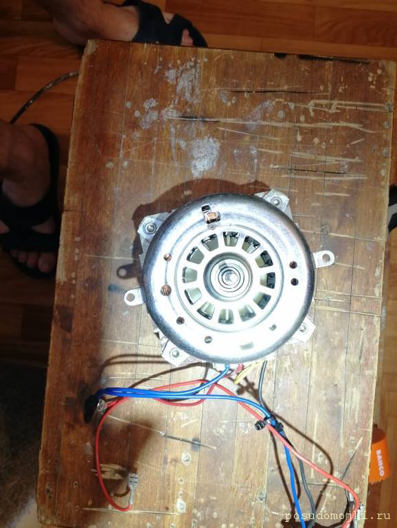

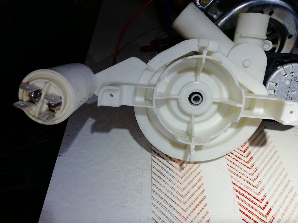

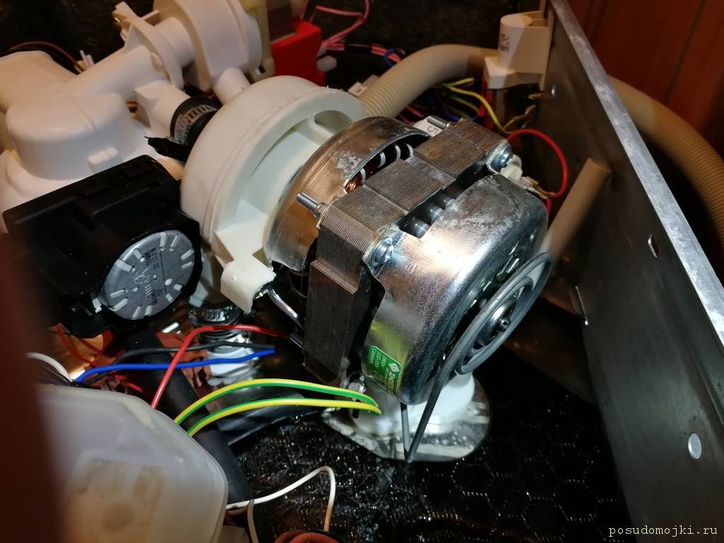

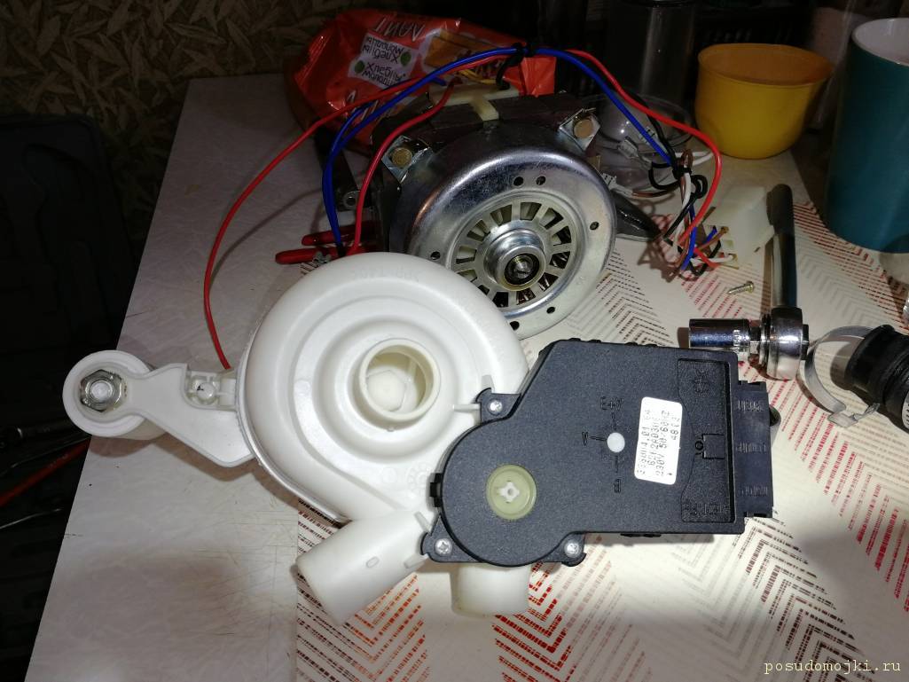

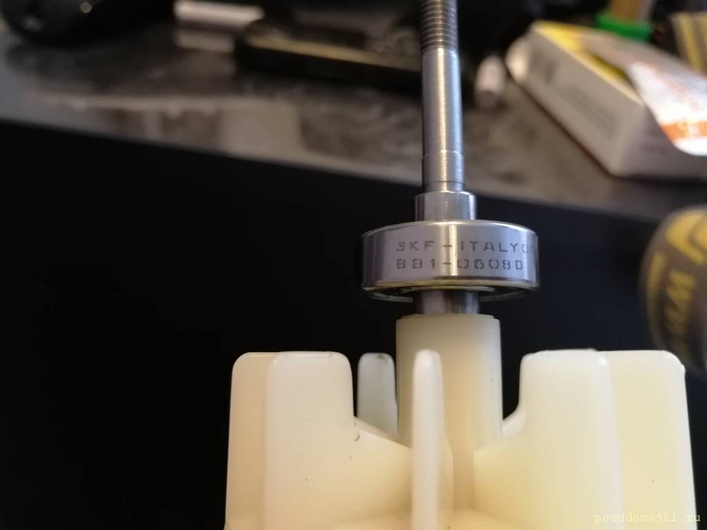

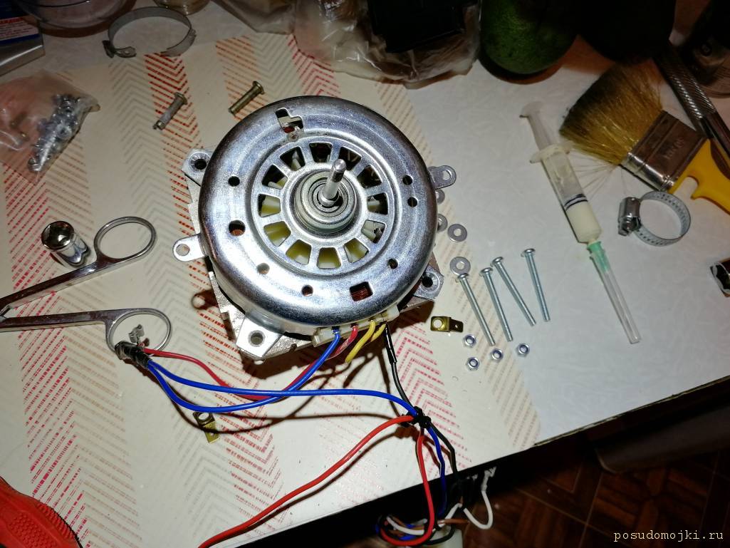

I mean, it ate the pulley?!)))) how is that, and because of this, change the machine?! :ROFL: The pump is completely repairable, it’s not difficult for me to repair everything, the bearings are SKF BB1-0608, but the original is difficult to find, it’s easier to install nsk 608 and not worry, the motor is on rivets, you need to drill them, then assemble it with screws... The volute, don’t disassemble it, (attention, the screw on the volute rotor has a reverse thread) a new volute or if the old one is not leaking yet, inside, where the oil seal is better filled with hydra2 lubricant, it will work longer!
