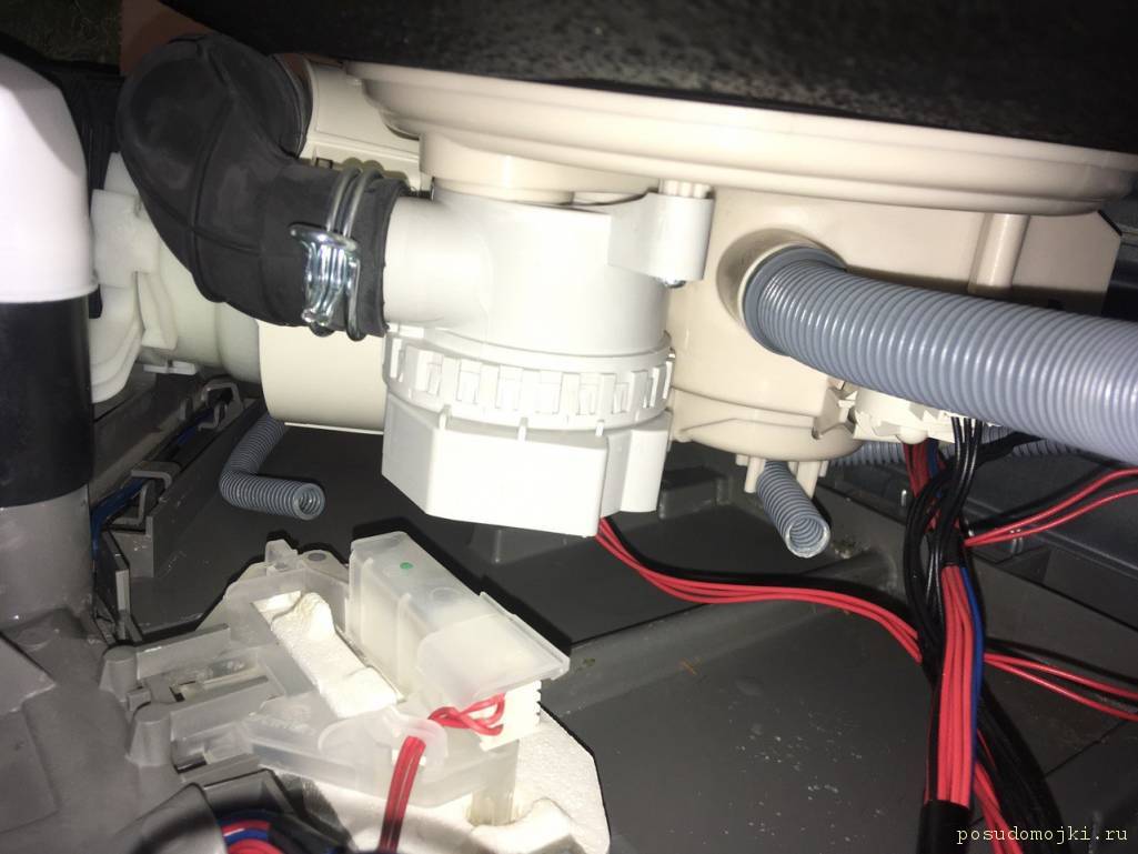

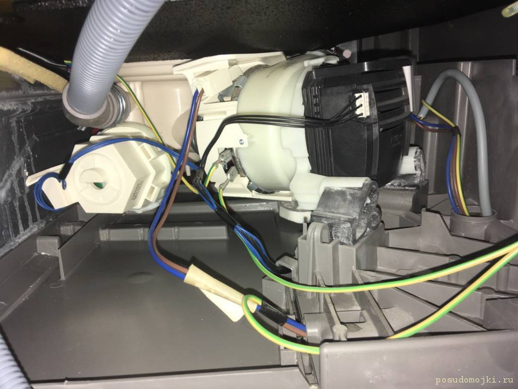

Please point your finger at where this pressure switch is hidden.. I think I found what it looks like and is on sale, but I don’t see it at home)))
IKEA SKINANDE(Elektrolux) 911536047
