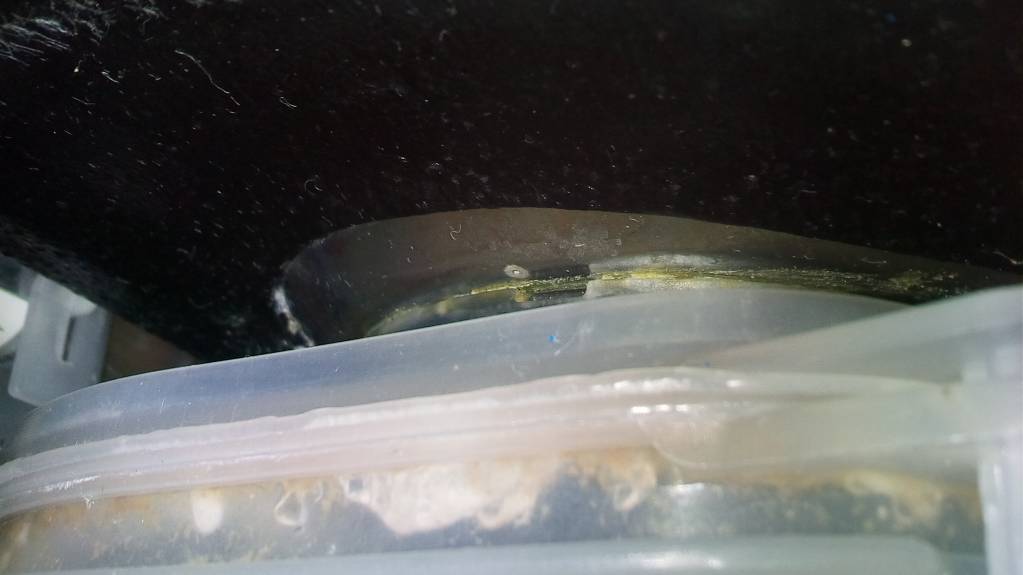

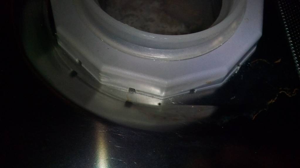

Good day! Recently, the BOSCH dishwasher started producing E-15 (leakage). Having disassembled and reassembled a couple of times, cleaned, etc. didn’t solve the problem. It turned out to be simpler, there was a hole in the body. How can I fix it, please tell me?
 Re: Bosch E15 (hole in housing)
What has no one encountered? Maybe cold welding?

This happened from spilled salt. Soldered with a soldering iron and tin without rosin. etched with acid.
