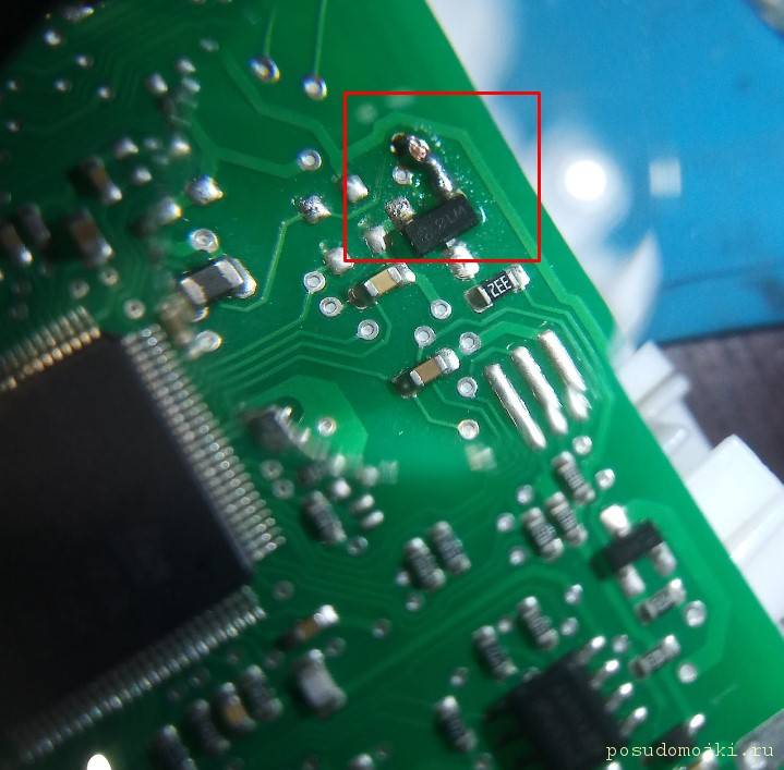

ViperRUS, I understand that 6 years have passed, but suddenly this problem was solved. My dishwasher has the same symptoms. I bought it in this condition, brought it home, and it started working! But cockroaches crawled out of it, I took it apart, carefully got rid of these fixes and cleared away traces of their presence, but when I put everything back together, it stopped starting again. The program is selected, the floor indicator is on, but there is no movement. A few minutes later it issues E27, although the washing machine works from the same outlet every day.
Vrastrub
 Re: Water supply does not turn on / washing does not start.
Post by Vrastrub »
ViperRUS, I fixed mine. The launch command did not pass. Those. it was possible to select a program, but after pressing the "Start" button and closing the door, no power units started working and the countdown did not start - the time for the complete execution of the program remained on the display until error E27 was displayed. After a more thorough inspection, I found a barely visible section of the track in the processor harness, etched by cockroach waste. The bell rang - bingo! I quickly threw a vein, everything started!
The water supply does not turn on washing does not start. - Screenshot_4.jpg
