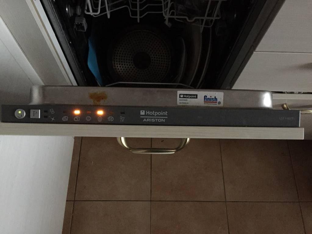

The light went out while the machine was running. After that, in the middle of each wash, the machine pumps out the water, and then indicators 2 and 4 begin to flash. After turning off by pressing START/RESET, the machine turns on itself after a few minutes and begins to pump out water that is no longer there, and turns on these indicators. I didn’t find any information in the instructions. I removed the filter from the drain and cleaned it - it didn’t help. A little water remains in the drain below after each wash, but I think I read that this is the norm. What can be done?

This is how it all happens: the machine drains the water. I can’t understand what the problem is. https://rutube.ru/video/private/cab21d0 ... wEA2uUtJQA

Same problem. The master determined that the heating element had burned out.

I had the same problem...... the drain pump turned on for no reason (if the dishwashing program was turned on, an error would appear in the middle of the cycle)
The reason is trivial: the siphon drain under the sink was clogged (the water did not drain well), The drain from the PPM is connected to the same siphon. and the pump drove water back and forth + when the sink was used, water was drawn into the PPM and the pump was activated.
