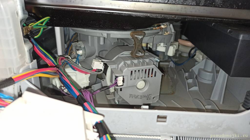

I’m correcting myself. It helped for about three months. I called the service technician. Result: both gaskets are leaking and dripping onto the electronics unit. 8 thousand repairs. There is a puddle at the top, there is a puddle on the floor of the car.
