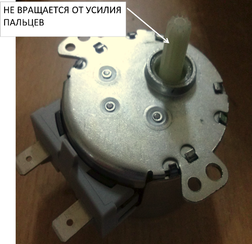

Good afternoon.
Help me determine the reasons and method of repairing the bosch dishwasher SMV47L00RU/09.
In the last couple of months, it began to wash dishes poorly and not wash out the tablets, after which I noticed that the upper rocker stopped rotating in during the washing process and water flows out of it in a small stream. Having looked at the Internet, I decided that the water supply tubes to the rocker were not clogged - everything was OK. Then I got to the water supply pump, visually everything is fine there too. What could be wrong? Or has the pump lost its performance and does not create the necessary pressure? If this is the reason, then how much does this spare part or its repair cost? Is it possible to somehow check it and confirm its malfunction?

Continuation of the repair process: when disassembling the machine, I did not find any traces of scale or contamination, and salt was always used.
Attached is a photo of the state of the disassembled elements. I have also now discovered that the motor of the switching mechanism between the upper and lower nozzles does not rotate if you try to turn it by the output shaft. Tell me, is it supposed to behave this way (not turn from the effort of the fingers, or is this its normal state)?
