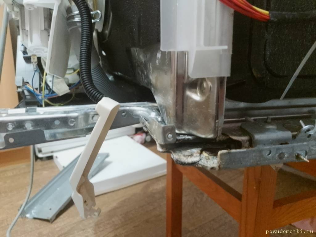

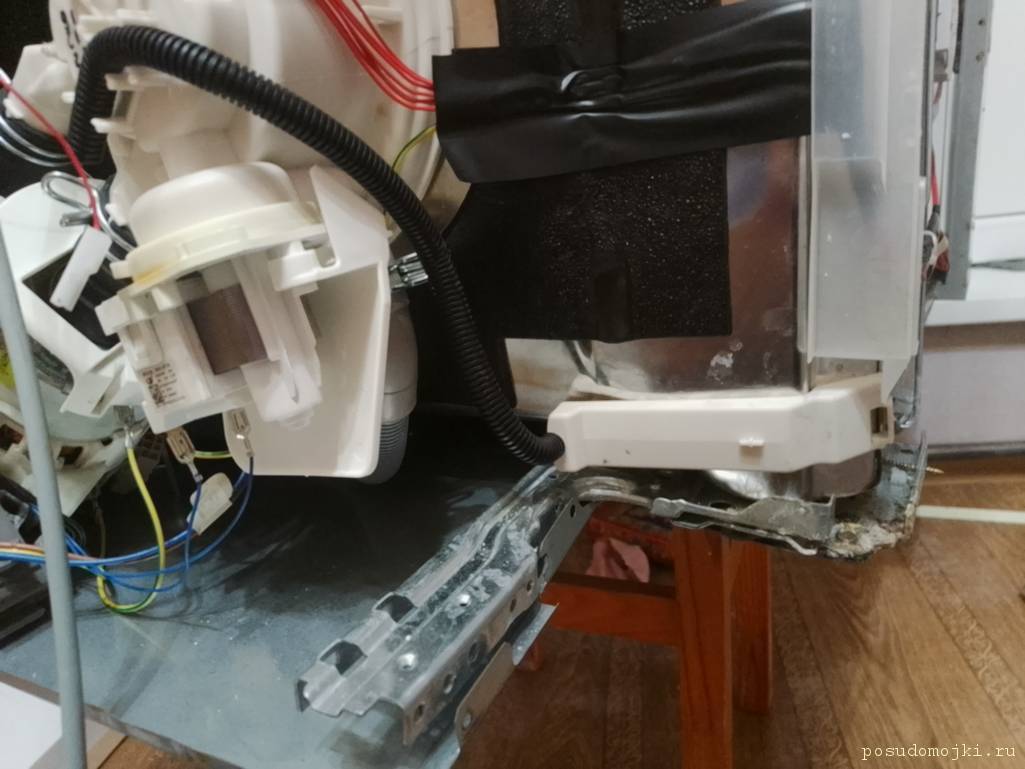

Hello. Help is needed. The dishwasher is leaking. When turned on, 7 minutes pass and the show begins. Moreover, water flows from a black hose (there are two of them at the edges of the bottom of the machine). It flows from the right one, you can see it in the photo. Please tell me what could be the problem

Check the pressure switch and its chamber, you have an overflow of water.
