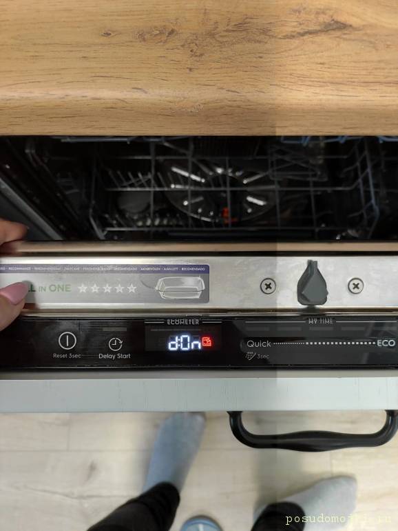

Brief background: it’s time for another PMM cleaning. Forgot what combination of buttons enables this function. We tried different options, then looked at the instructions and started the cleaning mode.
A minute later the machine opened, like everything was finished. After that, these symbols appeared on the display and now it counts the minutes as seconds.
What kind of game is this, please tell me?
I am attaching a photo.

Hello, I have the same problem, what did you do?
Psy40263
Re: Electrolux eeq947200l dishwasher counts minutes as seconds
You have demo mode enabled, disable it
