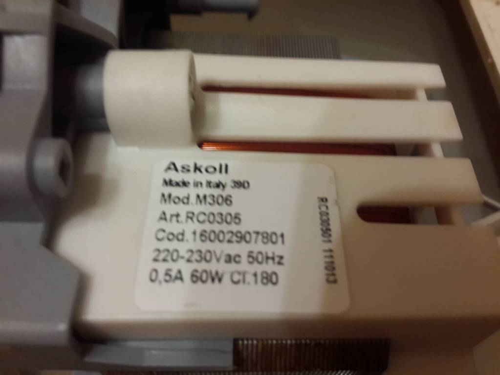

On the Indesit dfg 26b1nx dishwasher, the Askoll m306 recirculation pump broke (its markings are shown in the photo)!
You can’t find just such a pump anywhere, there’s not even any information!
Externally similar to m233, but it is 45cm for a car, and this one is 60cm!
Please tell me where I can find it or what other one I can replace it with!?
Thank you so much for the quick response!!!

There are plenty of them on the Internet. But you’ll never find them using this sticker. These numbers are not listed in any catalogs and are constantly changing. Search by machine model or by product part number, which is known to the service center employees.
