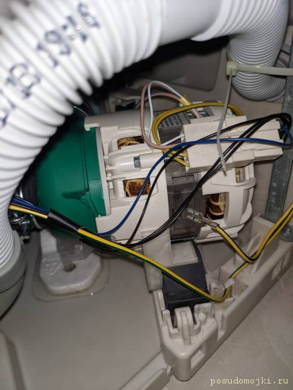

Good afternoon. Error i30, water in the sump. During operation, it leaks from the circulation pump. Could this be possible? What exactly might be leaking? Visually from the hole between the green and white parts.
Can it be cured with something or should I only buy it assembled?

Leaks not between, but in the area where the green and white parts touch

I am repairing the pump, you don’t need to buy it assembled, there’s a gasket under the volute and an oil seal (it’s probably leaking), everything can be bought separately!

I’ll tell you a little later, right now I’m just at work, the main thing is to find the oil seal, it’s spring-loaded and universal

First, you need to disassemble the pump ( unscrews counterclockwise) remove your oil seal, it is ceramic and select according to it.... It may also be that everything is fine with it, you just need to tighten it... Here is a video found

Finally got around to it. Everything is as in the video: all gaskets are intact. I washed it and screwed it back on. Not leaking yet. Thanks for the help!
I didn’t remove the tachometer, so I unscrewed the impeller.

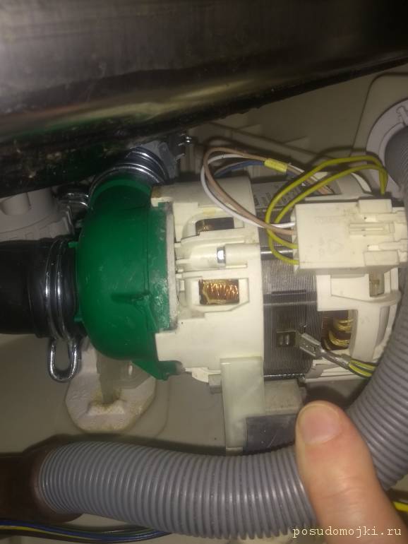

My dishwasher: AEG F65410mop
 Re: Circulation pump is leaking(?)
Post by psimo »
Hello. I have a similar problem with AEG F65410mop
Guest: 18 Mar 2021, 22:00 It leaks not between, but in the area where the green and white parts touch
Circulation pump 140000397020.
What to do? Who will help?

They also wrote above what to do. I just did it from the video. Disassemble and tighten. Be careful with the latches so as not to break them.
