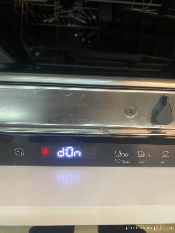

Good day, dear experts!
An incomprehensible error has appeared, after starting the program, it turns on and a program that lasts 3 hours passes in 5 minutes and the dishwasher finalizes the program and opens the door

Good evening! We have the same thing, how did you solve the problem?!

I found the answer on the forum. It helped.
« Press the Auto Sense and ECO buttons simultaneously for 3 seconds. The display should change from d:On to d:Of"
