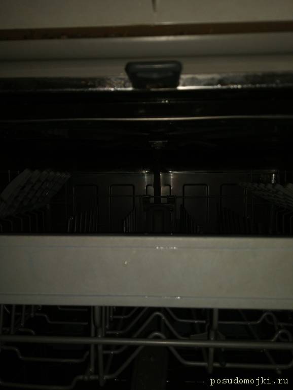

Hello.
Please tell me why the top of the door is leaking?
I changed the seal.
The upper sprinkler too.
It leaks without the lower sprinkler.
If you remove both, no.

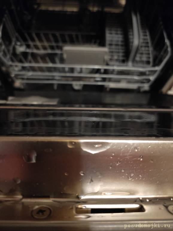

Thanks for the answer.
Fitment is fine.
How to check the wear of the hinges?
Initially the door did not stay in any position. It only stayed at 45 degrees.
The door closes smoothly. The latch works.
Seal (black) in the photo.

Maybe your seal doesn’t fit tightly and allows steam to pass through during the drying cycle? if the hinges are worn out, then a backlash usually appears, and there is also a spring in the door, a cable is frayed in the spring, through which the pressing force of the spring is transmitted when the door is closed, it also holds the door when opening and does not allow it to fall down, if the spring weakens there will be a gap.

Good afternoon.
I don’t get to drying)
No play (No gap *x)

Well then, condensation remains :unknown: maybe increased foaming from the detergent or rinse aid? :shock: there is always confidence that everything is smooth :ni-ni: and then it turns out that the seal is of poor quality, does not stick tightly somewhere, a microcrack or scratch has formed, something has gotten under the seal , a gap has appeared in the area of ​​the lock, the door is skewed, in any case, the tightness is broken :Search:

My Precious: 12 May 2022, 22:40 Well then, condensation remains, maybe increased foaming from the detergent or rinse aid? There is always confidence that everything is smooth, and then it turns out that the seal is of poor quality, does not stick tightly somewhere, a microcrack or scratch has formed, something has gotten under the seal, a gap has appeared in the area of ​​the lock, the door is skewed, in any case, the tightness is broken
I will try changing the hinges. They have wear and play.
