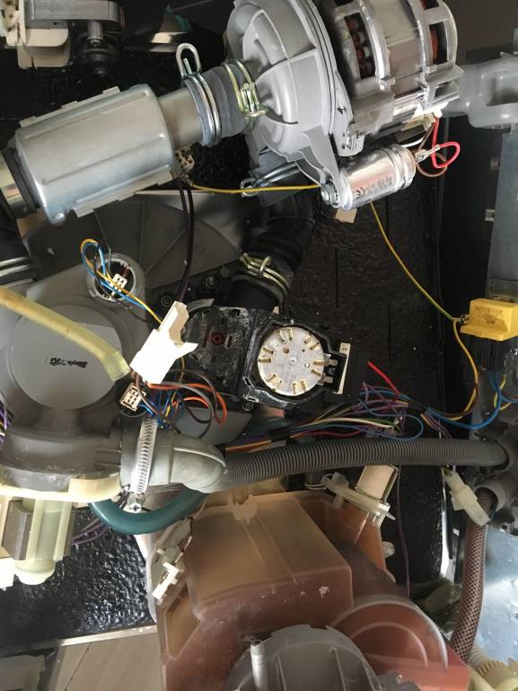

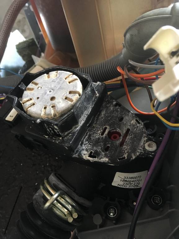

Dishwasher beko ddn 5832 x. The Aquastop worked, since the water did not fill, but the pump was working, I turned it off, unscrewed the front bar - Water in the sump. I removed the water, disassembled the car, it turned out that the water had been leaking for a long time, as there was a corresponding sediment on the parts. Question: where can the leak come from if water has settled on this spare part???

The deposit apparently has something to do with the salt that is in the tank and the pipes that come and go from the dispenser tank in the bottom of the washing cabinet. With good lighting, look carefully at all the connections around this tank. The leak may have been temporarily corroded by salt and is on the inconvenient, invisible side.
