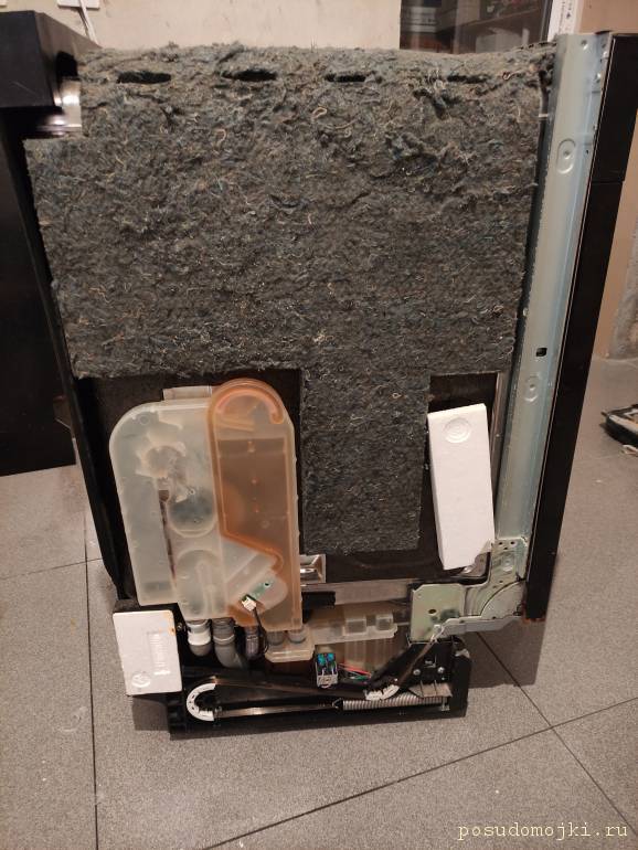

Regarding the error

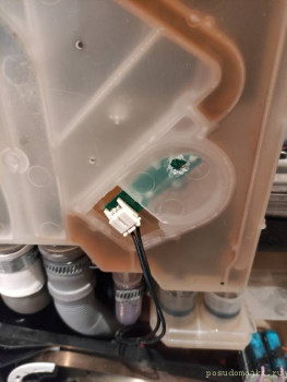

4E is a malfunction associated with filling the machine with water; if it appears at the moment of water supply, then the aquastop should work. You need to start with the inlet hose, or rather with the inlet valve, if everything is in order with it, then there is a possibility that the reed switch, which is located in the side tank, has failed (if you look at the machine from the front and unscrew the left wall), this sensor is on photo, sometimes you just need to move it, I made a hole to make it easier to adjust. The rotor itself, in which the magnets are located, may also freeze.
