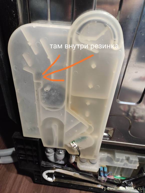

The same thing happened. In the compartment with the dishes there was a strange rubber band that looked like a check valve in the shape of an M6 bolt. It turned out that she was squeezed out of her place inside the plastic tank on the left side. It was squeezed out most likely due to a tee clogged with grease where the water drain is connected. I cleaned the tee, replaced the rubber band and everything was fine

how did you insert it
