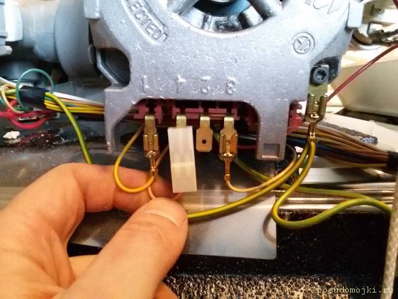

I took it apart, the impeller is intact, it holds tightly as a single whole. I have this suspicion. When the pump stops working normally, i.e. low pressure, I called a technician. When the technician arrived, the pump did not spin up at all; it turned out that the capacitor did not give the required value of 9 microfarads; they replaced it with another one, but the pressure did not appear. And the suspicion is that the technician simply mixed up the connections on the pump and it is rotating in the wrong direction, could this be possible?
 Re: No water pressure BOSH SRV 55
I found it on the Internet, but I don’t understand the same connection?

If the rotation is not correct, then there will be no pressure and, accordingly, there will be no heating either. I understand correctly?
Post by Novel »
Well, in theory, yes. But there the pump is powered by alternating current, that is, it always rotates in the right direction. And you can see from the impeller which direction it should rotate.
