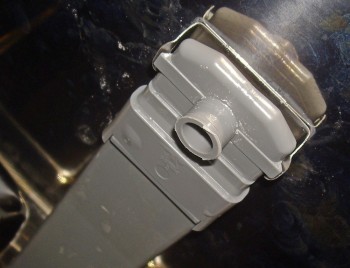

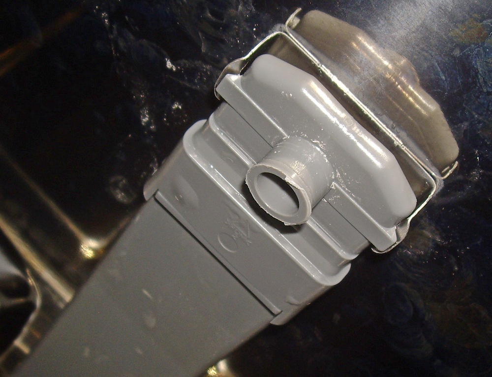

Hello!
The top sprinkler fell off, it was small, I don’t understand how it stayed there. Now you can put it on the plastic pipe, but it barely stays there. There are no rings or fasteners lying around in the car. Please advise what can be done, and if new spare parts are needed, where can I buy them in St. Petersburg? Photo attached.
Thank you!
 Re: MIDEA - the top sprinkler has fallen off

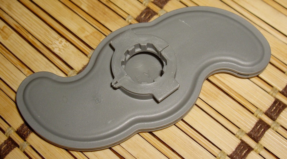

I answer myself, I’m sure this problem will crop up for everyone now. The sprinkler was held on the pipe by a flange made at the same time, it simply wore off, and so the impeller fell out. I couldn’t remove the pipe in the car - the hooks hold it tightly, I had to dismantle the entire pipeline - to do this you need to unscrew 2 screws on the bottom of the car, then you can calmly remove the ill-fated square. In the place where the original flange was, a spring ring was put on, made from a spring for keys - the spring was released by the flame of a lighter, the diameter of the ring was reduced, cut strictly along the circumference, somehow hardened, then pressed onto the pipe and slightly melted with a lighter .
The plastic clip, which is visible in the center of the sprinkler, is snapped out by turning it counterclockwise and separated into two halves. Then this clip is put on the pipe (our ring prevents it from falling off), and the clip itself, in turn, is inserted into the sprinkler and fixed as it was. That’s it, we mount the pipeline back, snap the sprinkler holder assembly into place. Everything is working. For how long is an open question; the design was originally developed by pests.

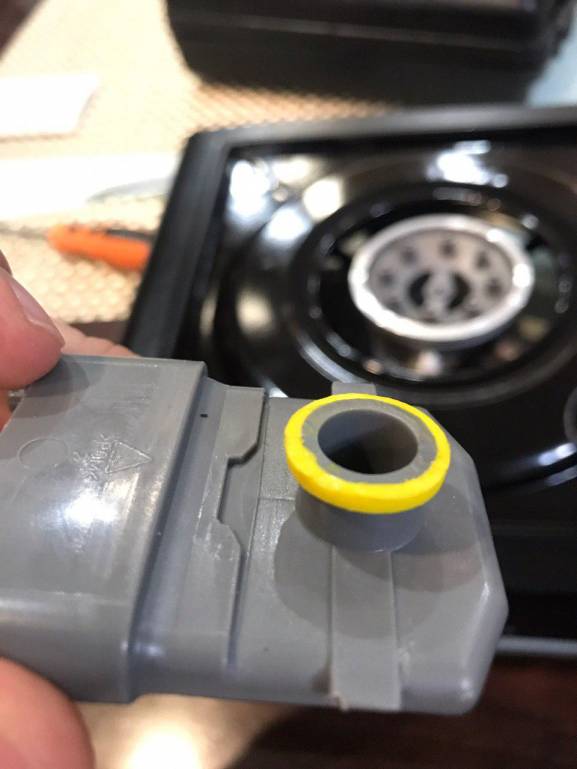

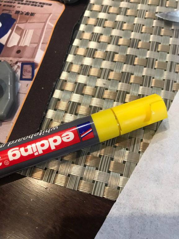

I have the same part on my Korting KDI 4550 dishwasher, because... As we found out, they are made at the Midea factory. I called the technician and said that the parts would have to wait 3-4 months and would cost 1.5-2 thousand rubles. While searching for solutions, I came across this forum topic.
CROAT, Rude, thank you for the detailed explanations of the reasons and your methods! If it weren’t for you, I would have waited 4 months for the “original” spare parts, and I would have paid 3-4 rubles per ring for installation of them...
I also tried to make a ring out of metal, but there was no way hand of the necessary tool. While wandering around the apartment, I discovered that the diameter of the whiteboard marker cover in the child’s room almost coincides with what is needed. I cut it in a circle with a kitchen knife, then sharpened it with a small knife from the inside and the ring fit! Then he secured it by melting the plastic in a circle with a metal rod heated over a gas oven. I am attaching photos.

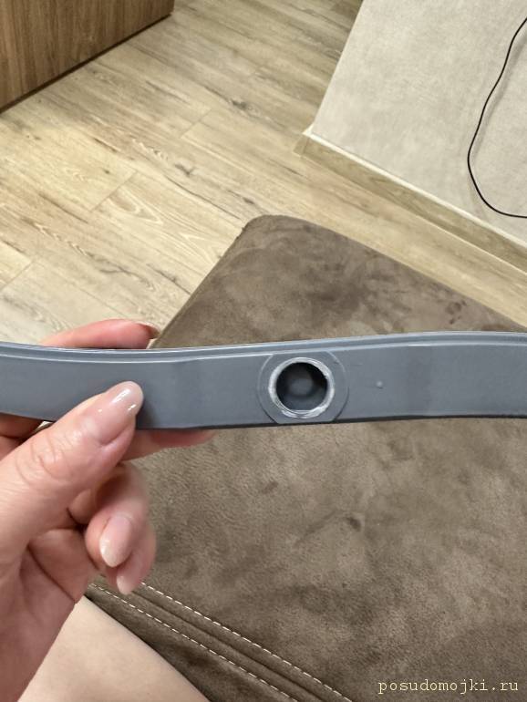

Thanks for the advice. The problem arose six months ago. At first, I didn’t remove the pipe, wound the fum thread around the edge (where the flange was cut off) and put the sprinkler back on. It lasted for 2-3 months. And today I came across this forum. The cap for nasal drops fit. I cut 1.5 mm off it and put it on (though with soap). Then I went around in a circle with a soldering iron.

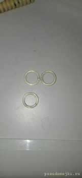

Good afternoon!
I encountered the same problem as everyone else in this forum!
I read several options on how to fix the situation, and I remembered that I recently bought a repair kit for a bathroom faucet, there were silicone seals, I tried to put it on the pipe from which the upper impeller with nozzles flies off. It went in with a little tension, the main thing is that it doesn’t wobble. By removing the sealing half-rings, I put the impeller in place. It turns easily, I tried to pull off the impeller with a light force, it holds perfectly!
I washed the dishes twice and it doesn’t fall off!
Maybe someone will find this option useful!

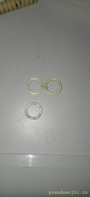

Хайер
Хайер
