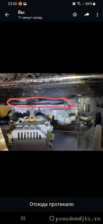

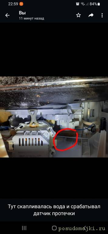

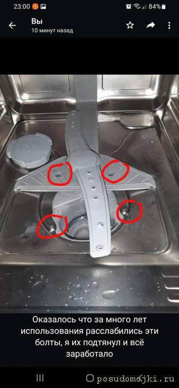

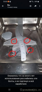

Today I got busy and determined the cause, solved the problem
Water was leaking at 70 degrees at the junction of the metal bottom of the tank and the plastic base on which all sorts of pumps are mounted, I solved the problem by tightening 4 screws on the bottom of the tank of the car from inside the washing compartment. 2 screws are immediately visible, and 2 are hidden under the removable coarse filter
I’ll try to add pictures if I figure out how to do it

Tehnolog, handsome, got to the bottom of the problem, there is a special repair kit that seals this place, part number from Bosch Repair kit seal Bosch 12005744 white
