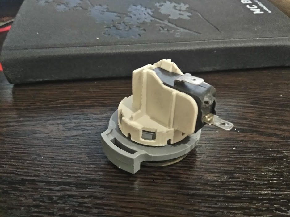

The same situation applies to dishes. flavia. During the last start, the contact on this part still sparked. Who knows what it’s called?
Hotpoint Ariston LSF7237 overflowed into the hydraulic valve. - IMG_20191221_180302.jpg

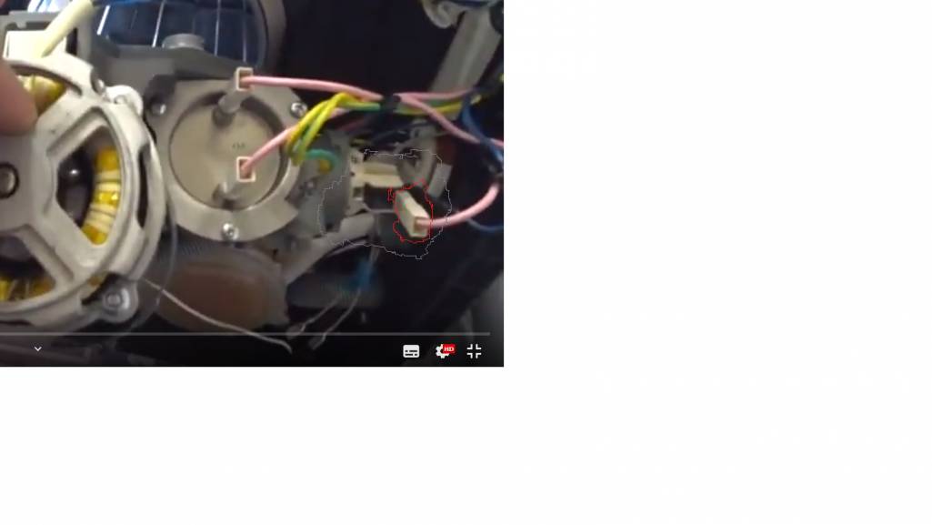

Место крепления. Скрин с похожей посудомойки Вирпул
