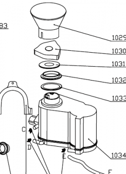

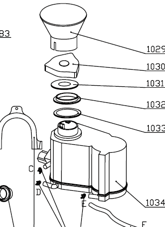

How can I replace the salt bin for Flavia Ivela. Didn’t find it anywhere. Apparently they are setting someone up. Maybe someone knows?
 Re: Flavia Ivela does not fill with water after winter
Do you mean water softener?
n It can be purchased. After replacing it with a regular hose, did the aquastop in the pan stop working? I didn’t understand the point, the original hose has an aquastop that protects against overflow.
gesha
Post by gesha »
Yes, this tank. By the way, could you explain how it works? Why three hoses? What are the reed switch and electromagnet for?
But the circus continues. Replaced the reservoir with a used one. Now it pours, rinses, drains, but... just before washing (after rinsing) it no longer pours. It’s buzzing, something seems to be making noise, when you open it, nothing drips and the sprinklers are in the same position, the tablet fell out and lies dry. And all this goes on for a long time. Then "like drain" rinses normally again and dries. EVERYTHING is correct except the washing machine itself with the tablet. Nonsense.
