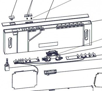

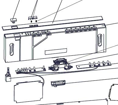

Good afternoon Perhaps the machine did not complete the wash cycle, and opening the door interrupted the program, hence the error. If this is the case, you need to turn on the dishwasher again, after rebooting, do not open the door and wait longer, even when everything calms down, wait 20-30 minutes. If this is not the reason, and judging by the description this is not the case, there is a possibility that the contacts in the control panel have oxidized due to water getting there or the control board has failed. To solve problems with them, it is better to contact a service center. It’s still quite easy to get to the control panel, you can see for yourself where it is located, if you decide to get to the control panel yourself, you can wipe the oxidized contacts with an eraser.
Flavia 45 Ivela Light stops washing after 30 minutes with an error - пульт.JPG
