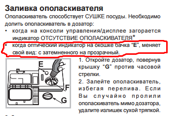

tell me where is the indicator for lack of rinse aid?
Sent after 4 minutes 40 seconds:

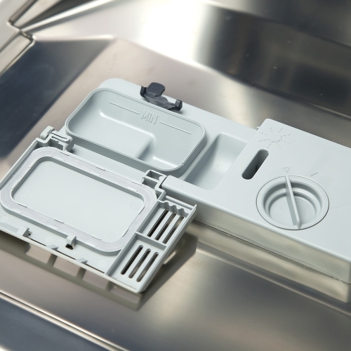

Here is some kind of sun drawn here, and the instructions say that it should change color as the rinse aid decreases. but I don’t understand why there should be a color change. There is most likely no indication on the display either.
Sent after 8 minutes 46 seconds:
what should change color here?
[size=85][color=green]Sent after 4 minutes 40 seconds:[/color][/size] Here is some kind of sun drawn here, and the instructions say that it should change color as the rinse aid decreases. but I don’t understand why there should be a color change. There is most likely no indication on the display either. [attachment=1]71108573_3.800x800.jpg[/attachment]
[size=85][color=green]Sent after 8 minutes 46 seconds:[/color][/size] what should change color here? [attachment=0]Screenshot_5.png[/ attachment]
Most likely, the snowflake symbol should light up on the display when there is no rinse aid; this is a standard symbol on dishwashers. What is written in the instructions may apply to other modifications of dishwashers from this company, but the instructions are the same for them.

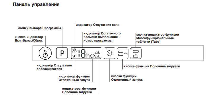

[attachment=0]Screenshot_1.png[/attachment] This is all the indication on the board. there is no rinse aid. so how do you know when it’s over? about stains on dishes?
