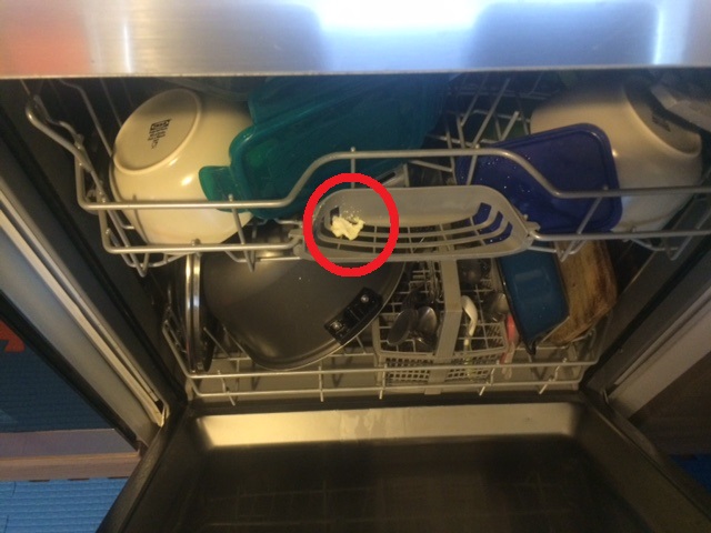

The question is related to Bosch SMV40D00RU/34, the car has been washed regularly without any questions since December 2014, I add salt and use Frau Schmidt tablets. Over the last month, 2-3 times I noticed the following: in the morning I open the machine to take out the washed dishes, and I see on the top pull-out tray (next to the pocket where the tablet is charged before washing) there is part of a melted tablet (the first thing I thought was that I accidentally forgot to close it sliding pocket door, now this is excluded, very careful with this point now):

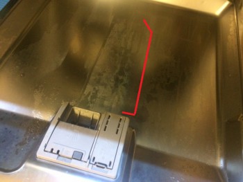

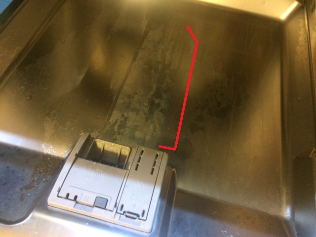

and under the pocket where the tablet is inserted, to the very bottom, there is a cloudy trace along the wall, it looks like it’s dripping soapy water along the wall and leaves a mark:

What worries me the most is the tablet, which for some reason- then it ends up on a pull-out tray, it turns out that it lies there and soap drips from it onto clean dishes... it turns out that some of the dishes need to be washed off additionally.
How to cure?

Check the injectors in the rocker arms. Perhaps the holes there are clogged with some kind of dirt and because of this, the water does not get where it is needed - including the compartment with the tablet.
