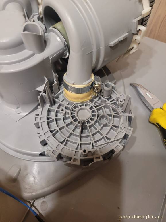

Hello!
After replacing the circulation pump, the machine became very difficult to wash, even tablet does not always dissolve. I put the camera inside - the impellers do not rotate. The original faulty circulator is 9000.713.246. Replaced with Copreci 9001.375.885. I wanted to check actuator - there is no motor on it, just a plug that always directs the flow of water into 2 holes at once. Thinking what to watch next?
Pmm bosch smv40d00 actuator without motor. How to fix it? - WhatsApp Image 2023-10-30 at 11.21.52.jpeg
